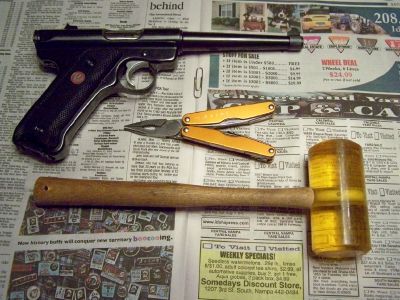

    The hammer strut isn't in the right place. You got to get the hammer strut back into the cup in the mainspring housing. Everyone makes this mistake the first time you take one apart. Tilt the gun muzzle up at a 45 degree angle and the mainspring latch should close without much effort, that's how you know you got it right.
    Check this out.
    Ruger Mark III Pistol Take Down and Assembly: Taking down and assembling a Ruger Mark III .22 caliber pistol for cleaning is not difficult, if done in the proper steps.  If not done properly, it can be frustrating.  If I let a long time pass without doing it, I forget how to do it. I…
