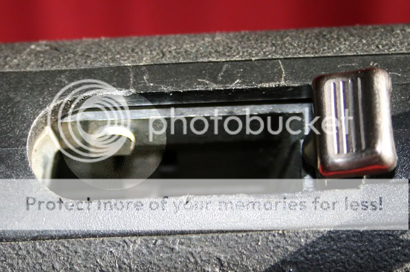

I am not sure if its magazine well is a pre or post (what I call) "nub".
At a point with the federal AWB they decided to make their older 15 and 25 round magazines for the M70 not work in newer firearms.
To do this they added a "nub" in the magazine well that would cause older magazines to not be insertable. New "Post" magazines have a cut in their side that allow them to enter the magazine well and not be bothered by the nub.
Look into your magazine well, do you see the nub?
Here are an assortment of magazines showing the cut in the side that corresponds to the nub and ones that do not have the cut:
If you have the nub then you need "Post" magazines.
New magazines are backwards compatible with rifles that do not have the nub
But older magazines will not work in new rifles without modification.
