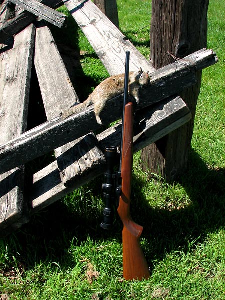

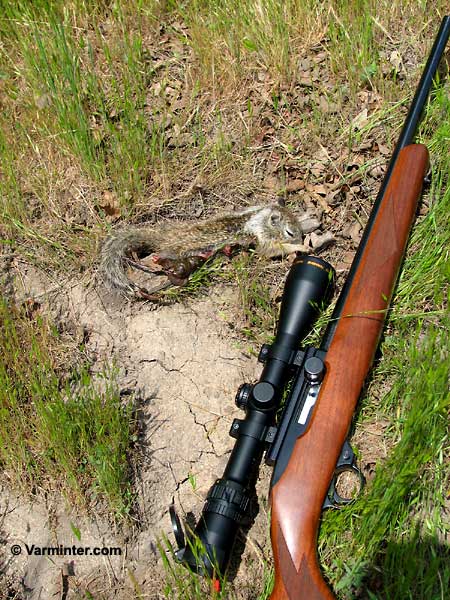

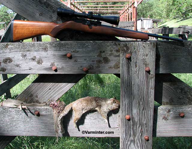

                  Do it!
                  First, there are way too many rifles out there for CCI to stop producing the ammunition. When you see it, grab a couple of cases and you'll be set for life (unless you shoot ground squirrels, then buy as much as you can).
                  I have the EA Brown heavy bolt conversion, with a Power Custom firing pin (I was having light strikes) and a factory contour, fluted barrel (I think it's a Green Mountain). I have had zero issues with this rifle, but I keep it clean and run some patches/clean the chamber after every 30 to 40 rounds.
                  Here are a few pictures of mine:
                  Tejon Ranch:
                  Tejon Ranch:
                  My buddy, Tom after shooting a cottontail:
                  Me with my Ruger and a small pile of ground squirrels (notice, eye protection, as well as gloves):
                  Ground Squirrel and Ruger 17HM2:
                  I had a Whistle Pig barrel version before this and it blew up a few times due to firing out of battery. WP blamed the ammo, Hornady blamed the tightness of the chamber. Needless to say, WP does not sell the barrels any longer.
                  You can find the kit on Rimfire Central or Gunbroker occasionally, so keep looking. Otherwise, I know folks go with a heavier spring as well.
