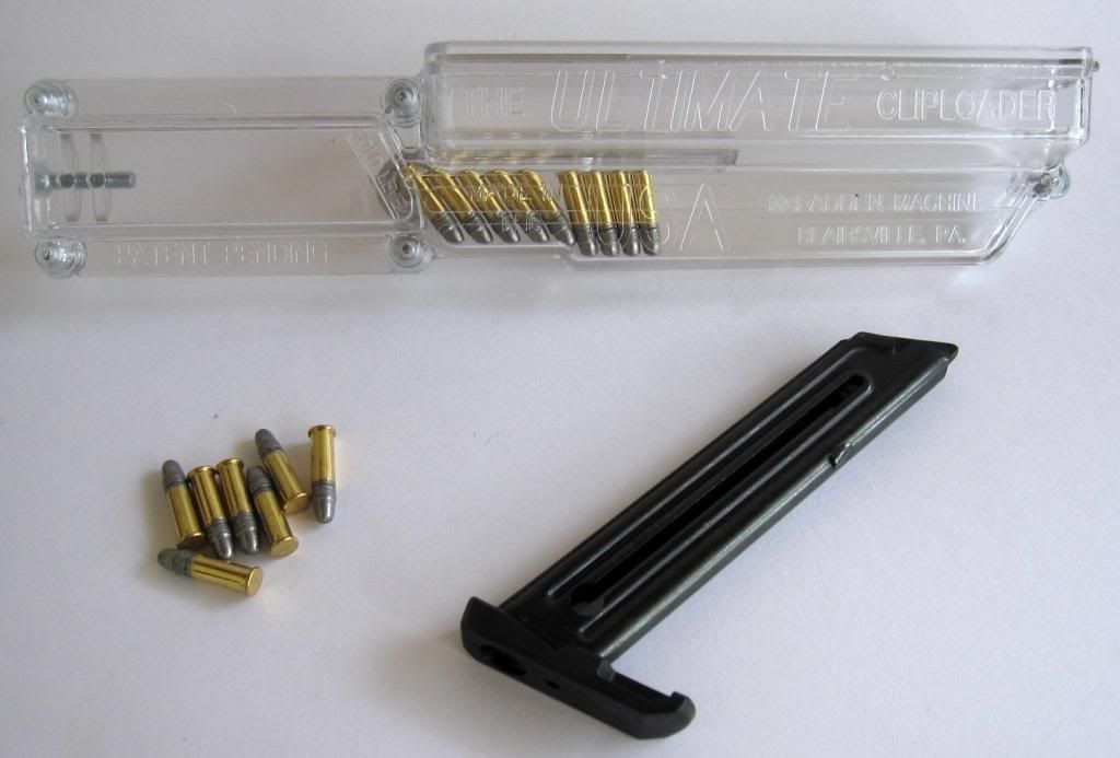

            Did you picked up an Ultimate Clip Loader?
              Yep. Mine is yellow, but it works pretty well. I wish they made them for a few other .22lr firearms I have.
