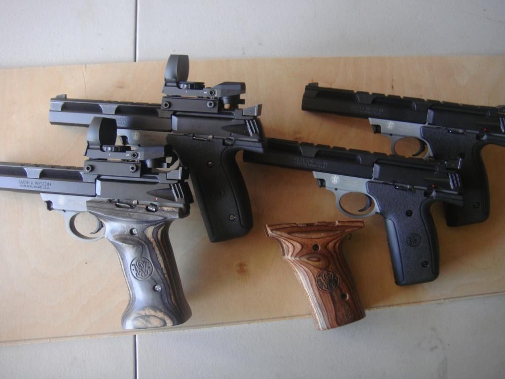

                Well after stripping the 22A and pulling out about a 5gl bucket of gunk. I pulled off the handles and found the lower cracked in half at the trigger pin. The only thing holding the lower together is the trigger guard. I am lucky the thing didn't blow apart in my hand while firing. My question is it worth sending it to try and get a new lower?
                  The 22A-1 has a lifetime warranty with S&W, however I don't know if it only applies to the original owner. Worth a phone call to S&W. Good luck. I hope the person who sold it to you was unaware of this, if not then he/she is verified dirtbag.
                    spitter3
                    • Jun 2007
                    • 244
                    Seems to be a common fail point on those pistols, a few examples on google that look exactly like yours.

                        My 22a frame broke at the trigger pin. Called S&W they sent a shipping label for FedEx. I am not the original owner. A couple of weeks later it was returned. I sent in the barrel and they replaced it as well.
