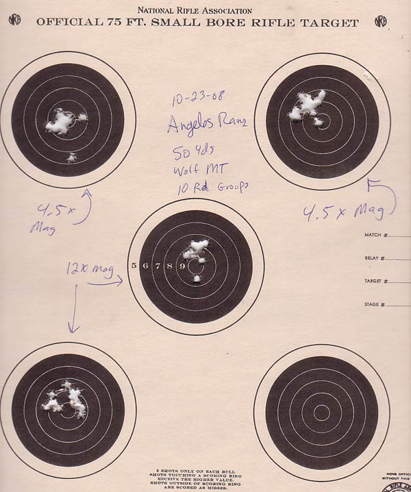

                        SK Std+ and Wolf MT (same ammo) shoots very well out of my Savage BTVS, 3/8" to 1/2" 5 shot groups at 50 yds and also just happens to be the ammo my other .22 rifles like the best. While those two ammos are the same for some reason my Savage likes the SK a little better. I have found that Lapua Center-X is more accurate but at twice the price is not worth it to me. The CCI SV ammo does not shoot well from my Savage and I get quite a few failures to eject with it but might do well in yours, worth a try.

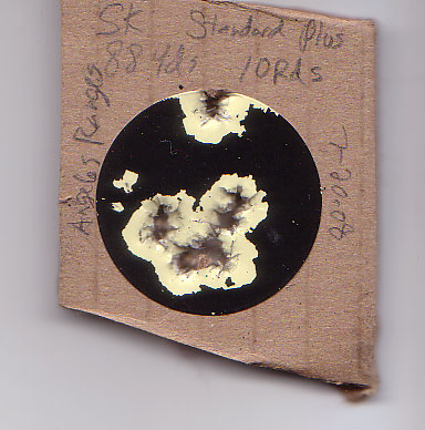

                          As an example, here is 10 rounds on a 3/4" shoot-n-see at 88yds:
