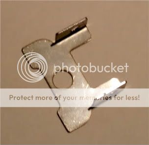

    So how do you bullet button the gun? I'm wondering how you will do this without running a mag lock, or what are you going to do there. I've been wanting a charger for years but with a mag outside of the grip its difficult. Even if you SSE the gun, you still have to come up with a mag lock for it and I have never seen one for a 10/22 yet.

      Use with a flat mag catch...old style original Ruger works fine.
      The upper "legs" get pinched in place between the action and stock when used on a Charger.
      You can add a pin hole into each leg and then use the mag catch pin hole in the trigger group (with a longer cross pin or 4/40 screw) to further secure the BB.
      Another view mounted on a Charger with one of my Pistol Kits.
