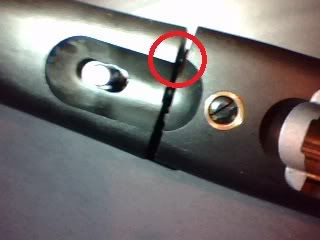

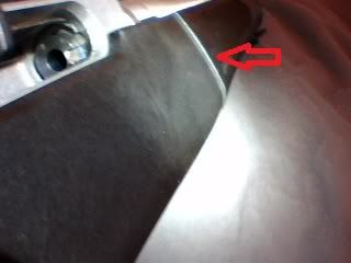

    I picked up my TD today. Cool! Got home and put it together. Hmmmmm...the forearm did not line up with the rest of the stock. I looked it over, then off to the good ole internet to see if I could fix it. Googled "10/22 TD stock alignment". On Sigfourm I found some people who had the same problem, and their sights were canted to the left. I checked mine and sure enough, canted. Well, being gun sales are final at Turner's, looks like it will making a trip back to Ruger.

          No, the ring adjustment has nothing to do with the misalignment issue. It just creates a tighter lock between the two halves.
          Mine locks really nice and tight, but the problem (that others are experiencing) is that when locked into place, the two halves are "twisted"; the ideal alignment is actually right before it locks into place. This results in my rear sight canted downwards to the left. Also, when I look at the bottom where the two halves meet, creating the oval shaped scallop, the oval does not line up at all. I know Ruger will correct the issue, their CS has a great reputation.

                      Here is the alignment of the stock, the sights are canted the same amount:

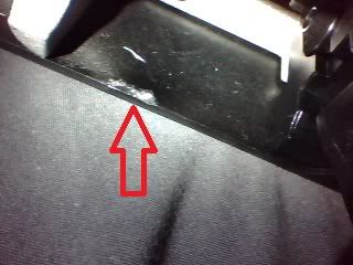

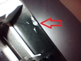

                      On a side note, the inside of the magizine well is chipped and looks like someone took a screwdriver to it. This rifle came out of a sealed box. It may be from molding the stock, but it does not look very good and I do not think it would sand out very well because it is on the edge:

                          Hmm, I have these exact two problems (misalignment and that chip in the magwell). It's time to call Ruger.
