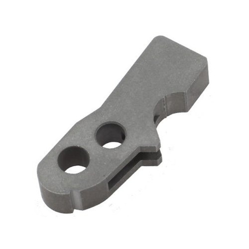

                      All I upgraded on mine was a VQ hammer and an auto bolt release
                      Volquartsen 10/22 Target Hammer at HawkTech Arms - Get the lowest prices on 10/22 Target Hammer!
                      It's a huge difference compared to the stock trigger. Now my 10/22 sits in an Archangel Marauder g36c body..
                              +1. Those two parts are money well spent. It will improve the function of the rifle considerably.
