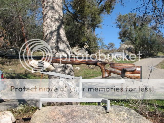

    Snagged a nutmeg stock off the site when I went browsing and received it yesterday, everything test fit perfectly. So I have dove in with the sanding and tru-oil
    Sanding done, ready for truoil
    First coat on
    Many more coats later curing for next wet-sand
    This is a fun project, cannot wait to have it finished and put together.

                It's the same theory as priming or varnishing the holes we drill for locksets and hinges on exterior doors. Keeps out moisture that can ruin a door and cause delam/swelling/cracking issues down the road. In fact most door mfg's won't warrant your door if you fail to do this. So on your nice looking stock I would seriously consider taking some oil or even thinned out (70/30) varnish and apply at least two coats to the bare lumber. At least enough to penetrate the wood thoroughly. After they dry you can then take an X-acto knife and trim out any buggers that may have filled the corners of the inset. So that your parts will fit nice & purdy........

                  yes people I coated the insides, its all smothered in oil luvins.
                  I'll buff it up in a week... anywho, here she is, The Marlin VERMINATOR
