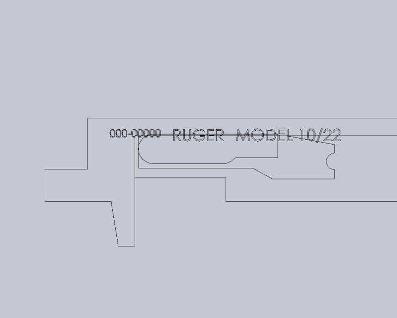

                            xibunkrlilkidsx
                            • Sep 2008
                            • 5419
                            looks like itll work. view is from the side of the reciever looking through it. the oveal shape in the background is the ejection/handle area on other side. so there is a good amount of meat in the bolt just below the model 10/22

                              G-forceJunkie
                              • 6496
                              The more I think about it, it would probaly be good to have the handle as rearward as possable, that way the new slot would be offset from the factory ejection port. Strength wise, it would be better.
