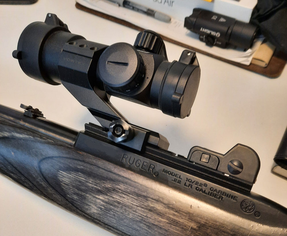

    The only way I was able to make this work is to purchase a full length rail and mount it to the receiver. Then mount the Techsight at the back and RD in front. I had a Vortex cantilever see-through scope mount and a Bushnell TRS-32 lying around and this is where they sit today. My "idea" was to have an Appleseed and Steel Challenge rifle all in one.
    Picture for reference...

      Thanks Mike. That definitely seems like the easiest option. I think I might go that route.
