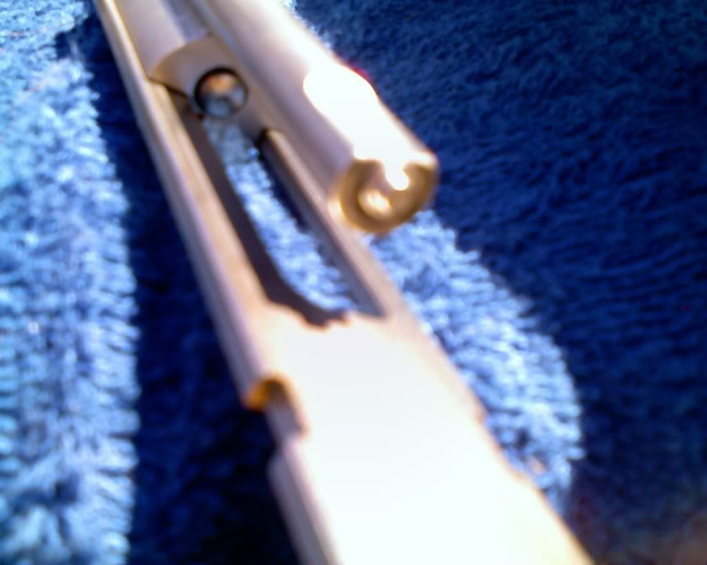

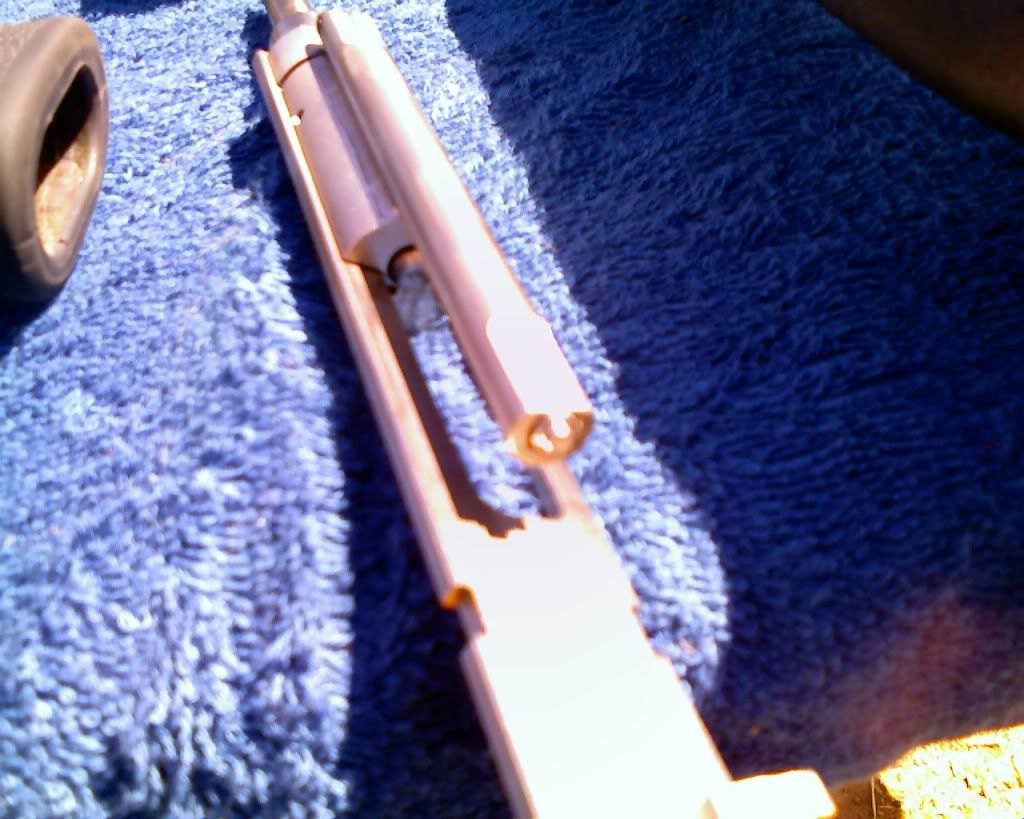

                          I had a problem with mine, the new rod got stuck when the spring compressed, will upload a photo in a little while. I put a plastic washer in front of it to solve the problem.

                            I'm betting the end recoil spring "hopped" over the e-clip portion and caused the jam.
                            I had a little binding, but noting close to a jam. I just bent the cut end of the spring down a little and it solved that issue for me.
