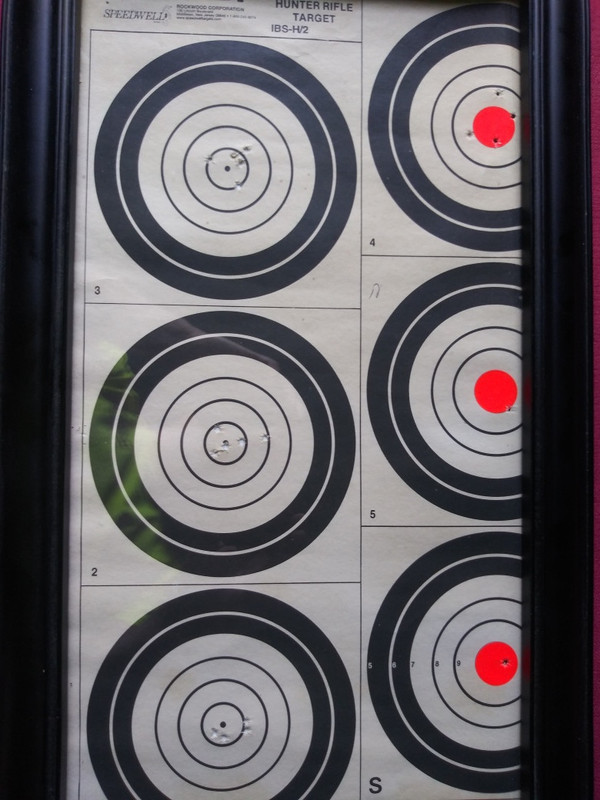

                  Federal used to make an "Ultra Match" .22 load, I used to buy it by the brick from the CMP. That stuff was standard velocity, and worked very well, even at USI when they used to have their .22 100 yard BR matches there at the multi-purpose range. John Labash used to run them..... may he rest in peace.
                  You can see the effect of the left to right wind on my target at USI. As Slamfire noted, there are wind flags at several intervals, and even with them calling the wind was always a challenge at USI.
