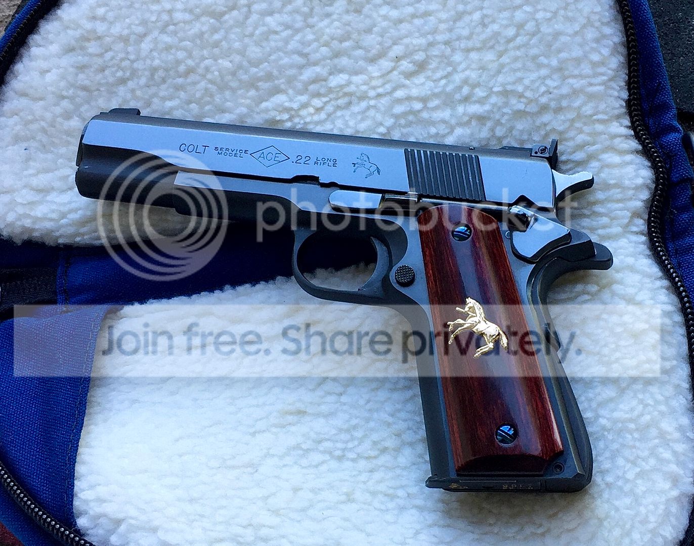

    You will need to get a REAL Colt mag which can be pricey. Some of the cheaper knock offs may work for awhile. Your unit looks to be from the 70s on up. I’ve had Colt SM Aces and conversion# since the 70s. I don’t use the conversions anymore just the real deal,the whole complete pistol. If you need help send me a PM. DO NOT DRY FIRE WITHOUT AN MT CASE IN THE CHAMBER! I could NOT get GSG mags to work in my Ace,they would bind so I’m not trying that route again. The Ace was not known for accuracy ( due to the floating chamber) but mine have been totally reliable with any and all bulk 22 ammo but after 4-500 rds without cleaning mine start to sputter. I know the Ace makes me a better pistol shot with any of my 45 autos having identical feel and trigger.
