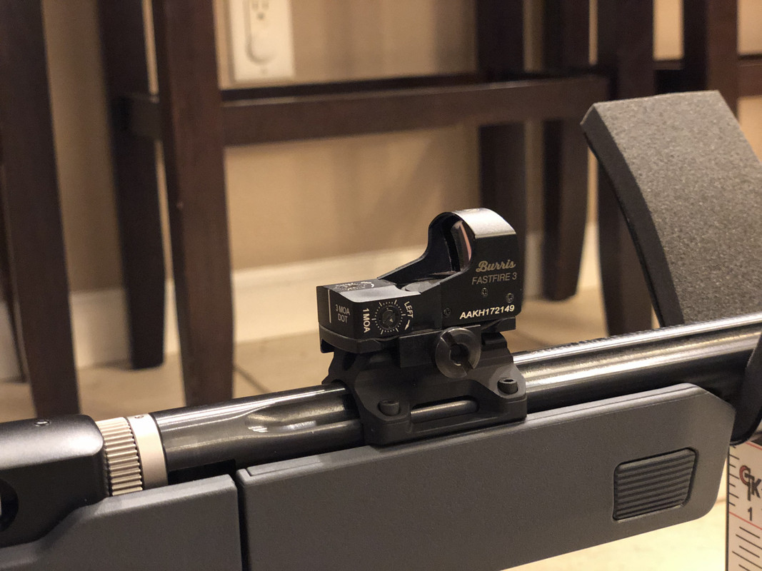

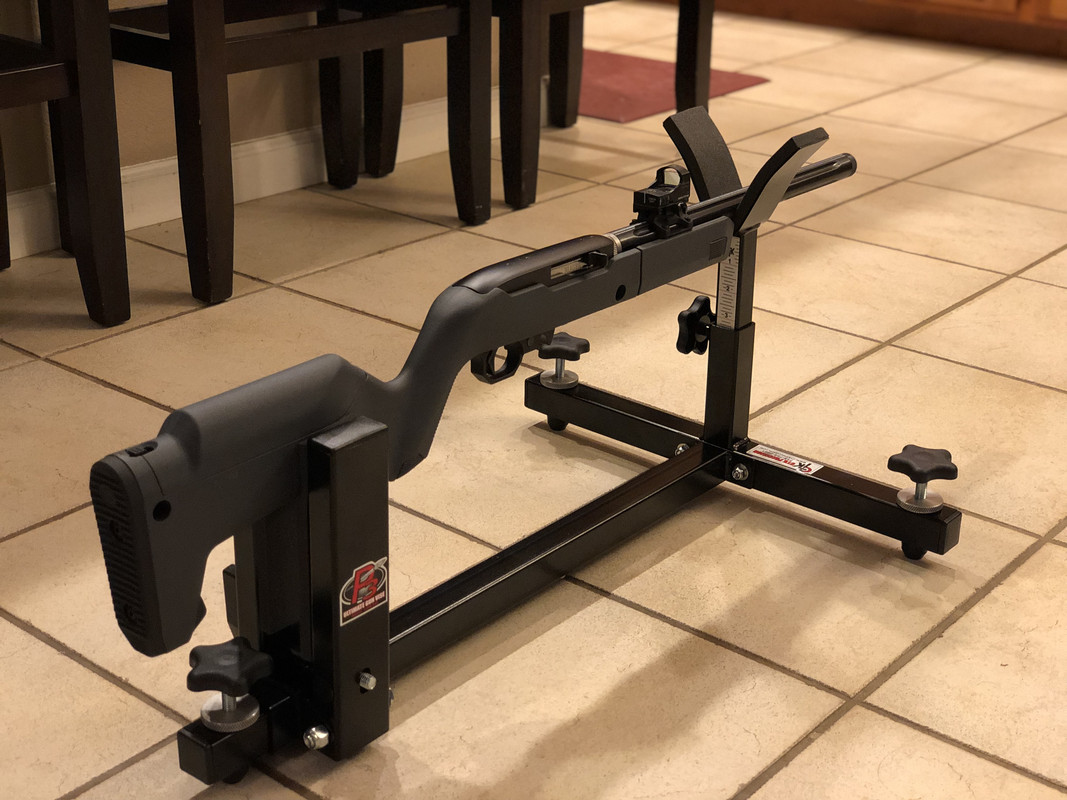

                    On my takedown target I went with a Magpul barrel mount and Burris FF3 red dot. IMO this is an ideal setup because it's inexpensive, accurate, holds zero, is relatively clean looking, portable, and still balanced.
