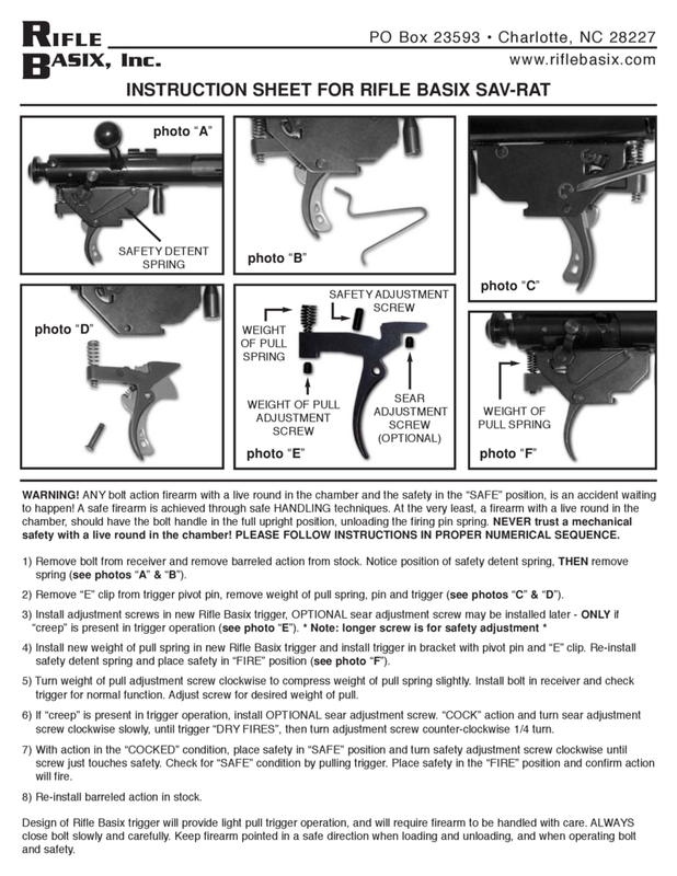

    Am in the middle of installing a Rifle Basix SAV-RAT Trigger in my Savage 93R17. Am confused as the trigger as received only has threaded holes for the Weight of Pull Screw and the Sear Adjustment Screw, nothing for the included long Safety Adjustment Screw, of which two were included in the package. This trigger can be used in other Savage Rimfires (Models Mark I & II) - is the Safety Screw meant for those models and not the 93R or did I receive a defectively manufactured trigger?

    Well, I think I figured it out. Just used one of long screws & spring for the trigger weight adjustment and installed the trigger. Adjusted to a very nice hair under two pound crisp break with no creep whatsoever. Passed the mallet test - heading to the range tomorrow to see if it passes there. So glad to be rid of that damn Accu-trigger - hated the safety blade and general shape of it.

      Just got off the phone with Jeff @ Rifle Basix. Apparently the trigger I received was mis-manufactured as it should have a threaded hole for installing the Safety Adjustment Screw as shown in the instructions. They are sending me a replacement trigger kit at no charge.
