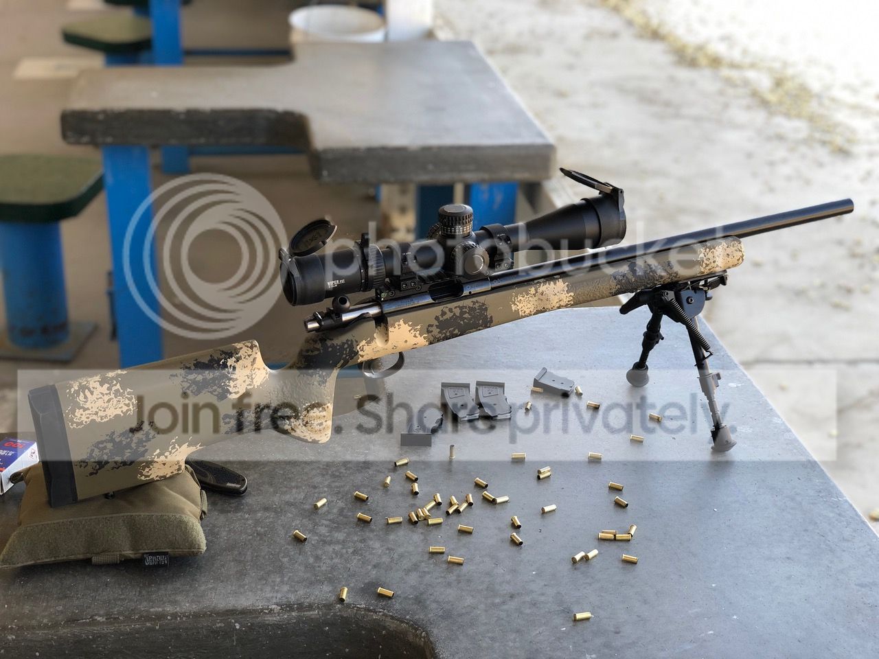

    Anyway, here's the rifle.
    CZ 455 Varmint in 22lr with the Manners Stock.
    Area 419 30 MOA rail
    Vortex Viper 3-15x44 FFP
    Harris Bipod and a MidwayUSA rear bag

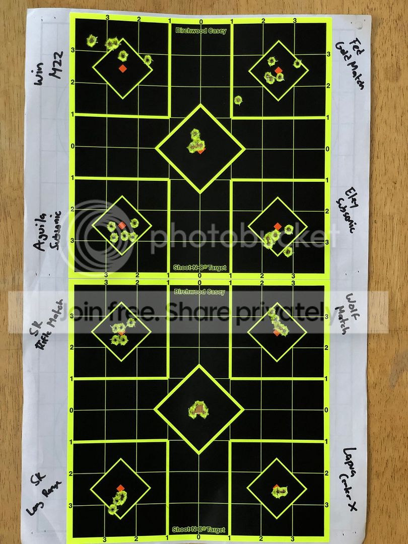

    I decided to shoot different ammunition and see what subsonic ammo works best for my rifle and just see what i can buy. I went through brownells catalog and ordered a bunch and had my dealer order a few others. All had 40 grain projectiles except for the Winchester m22, and unfortunately the SK Standard didn't make it in time.
    *Disclosure* I don't normally shoot for groups nor do I measure them so bear with me as I'm not an expert at this.
    Also these are all 5 shot groups.
    It was about 72 degrees with winds blowing left to right approximately 10 mph with gusts up to 14 mph.

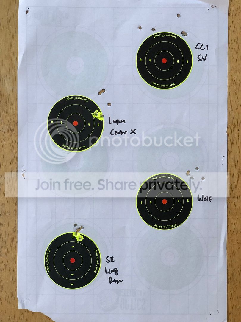

    I zeroed the rifle last week with CCI Standard and started with Cci standard just to confirm zero; top center target. The best Four would move on to 100 yards.

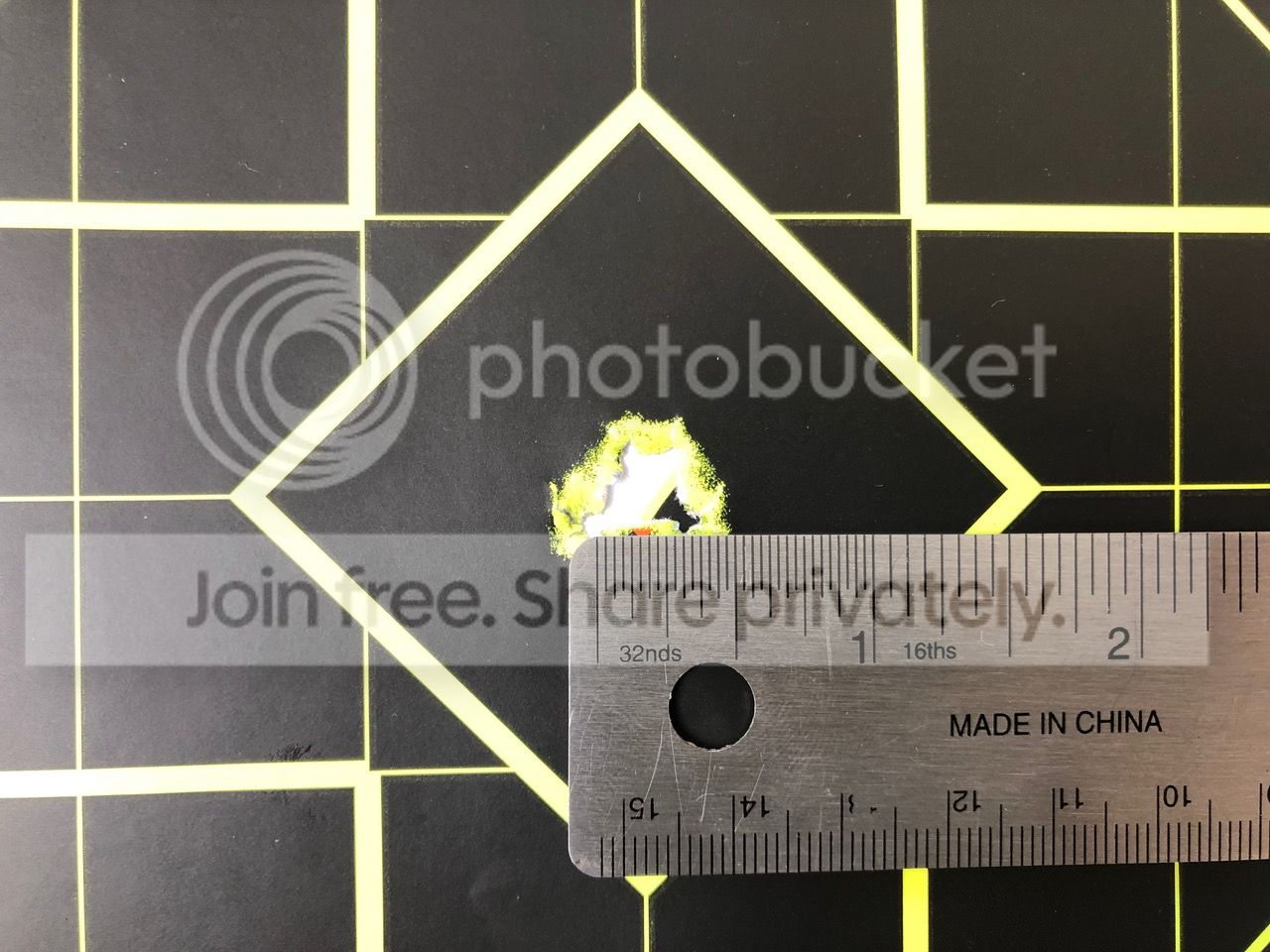

    Results at 50 yards:
    CCI standard velocity: 1/2"
    Winchester m22: 1 7/8"
    Aguila SuperExtra Subsonic: 7/8"
    SK Rifle Match: 3/4"

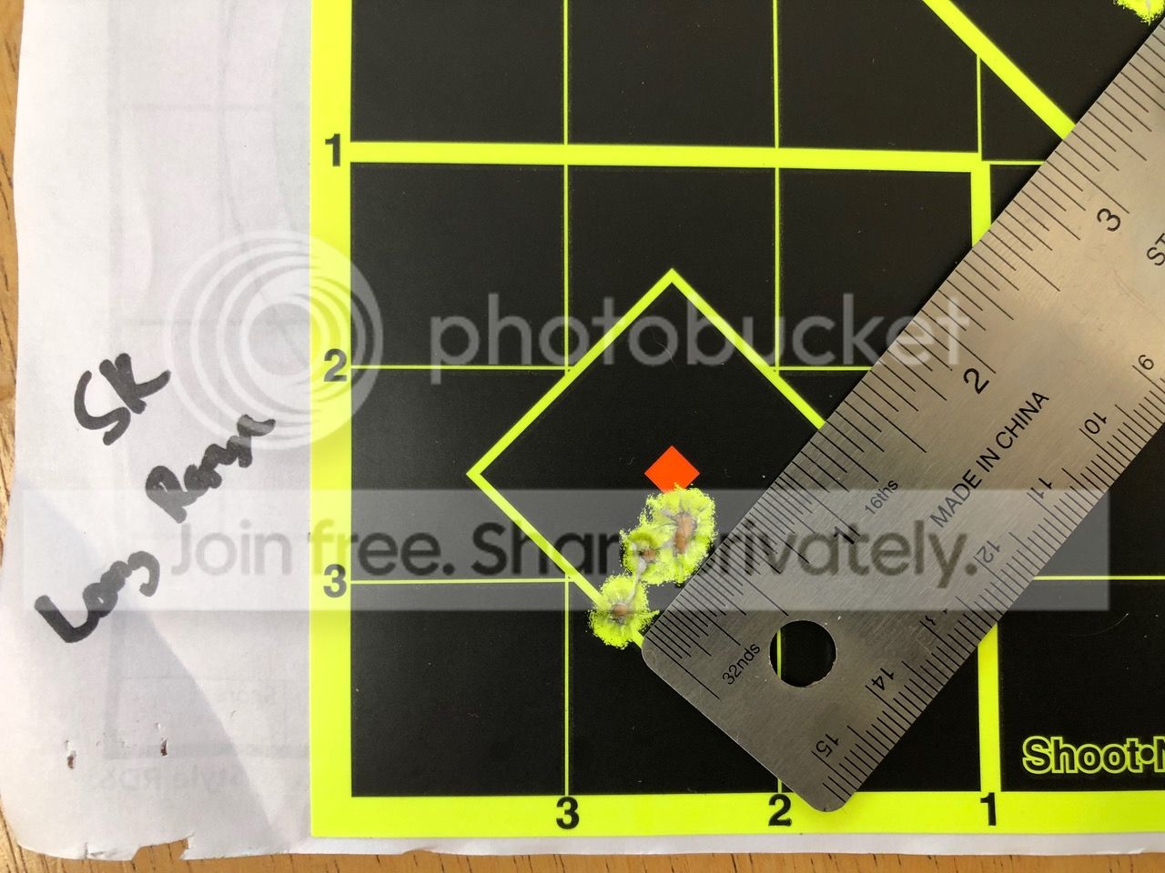

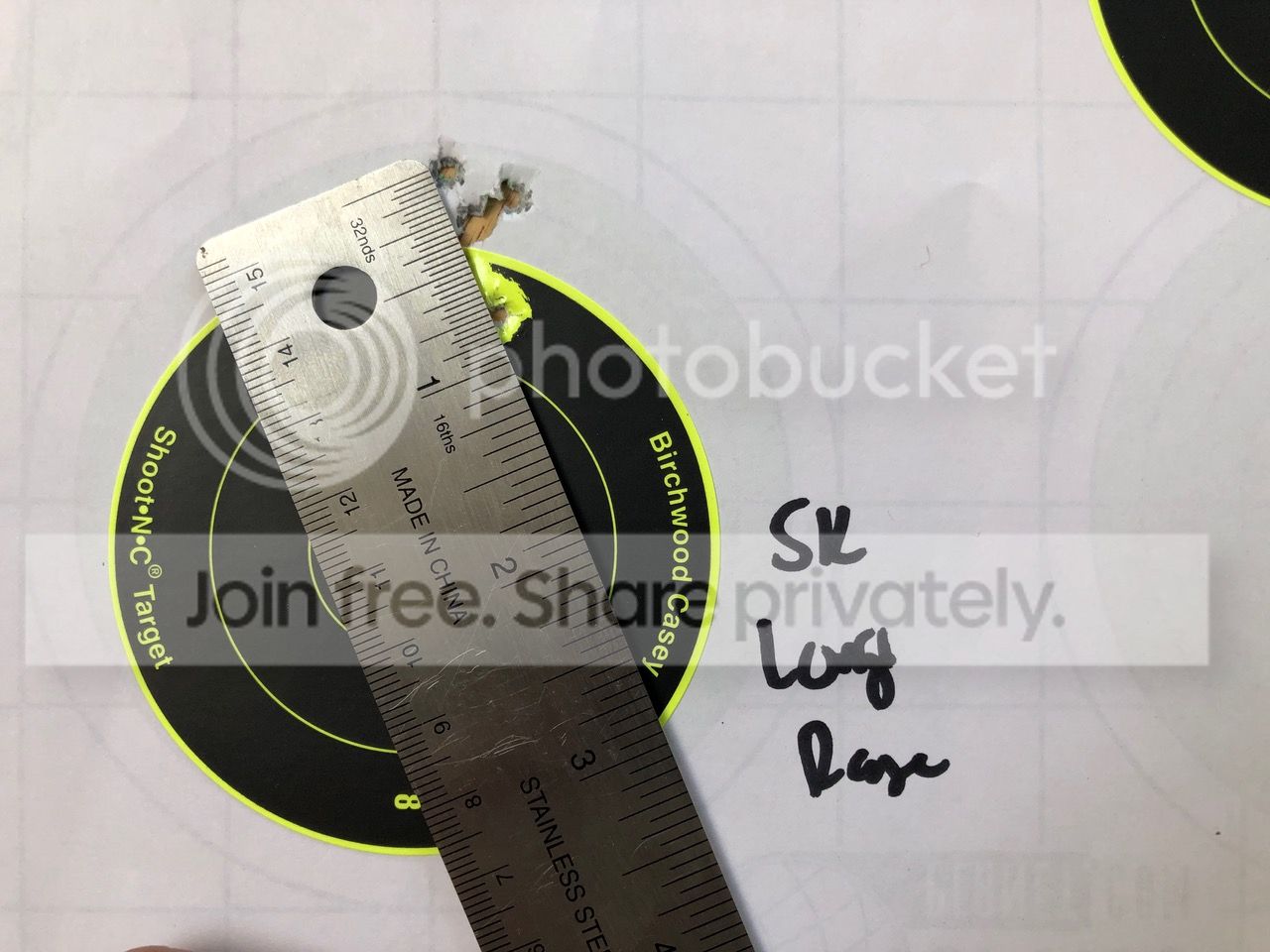

    SK Long Range Match: 1/2"

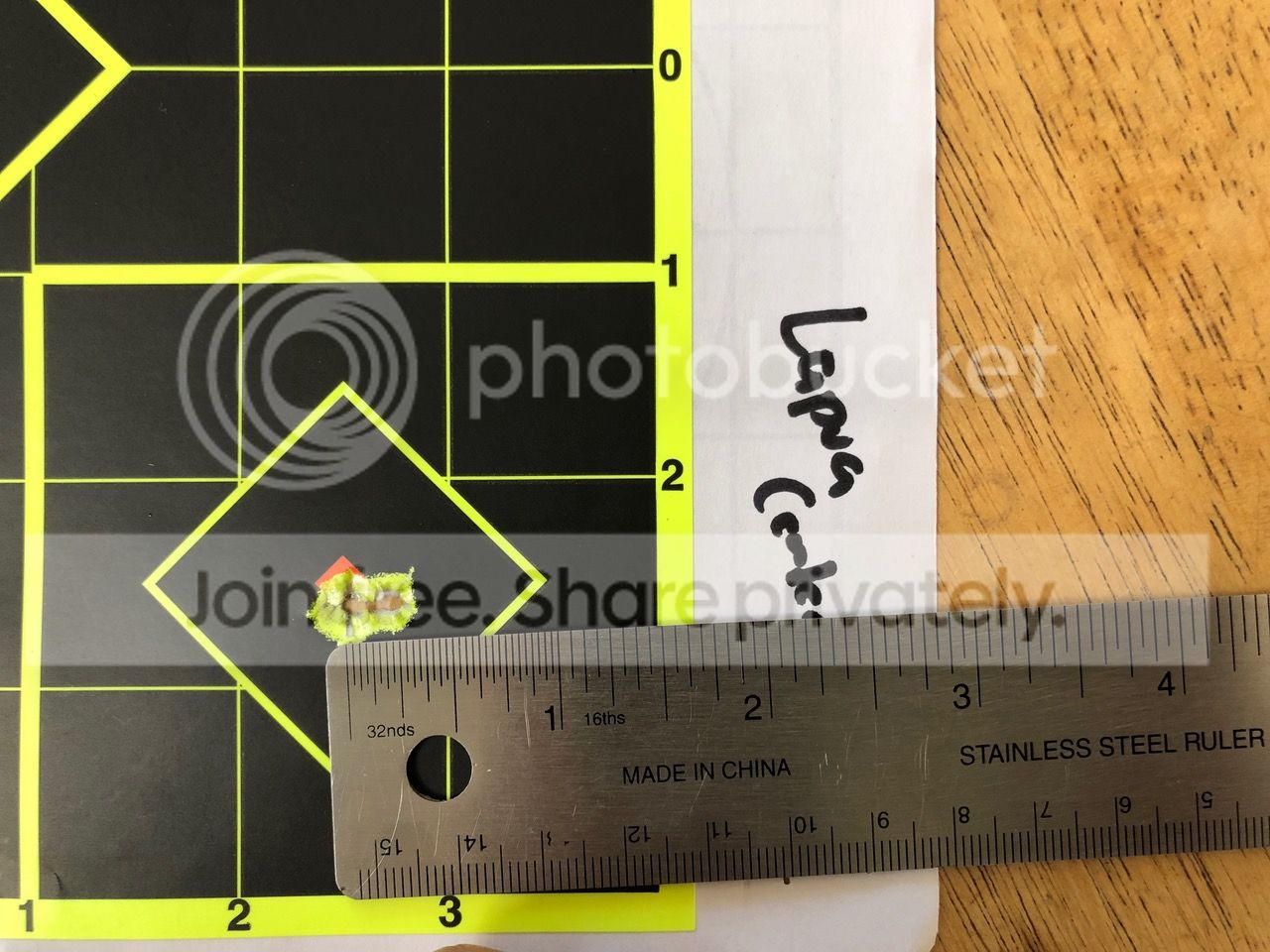

    Lapua Center-X: 1/4"

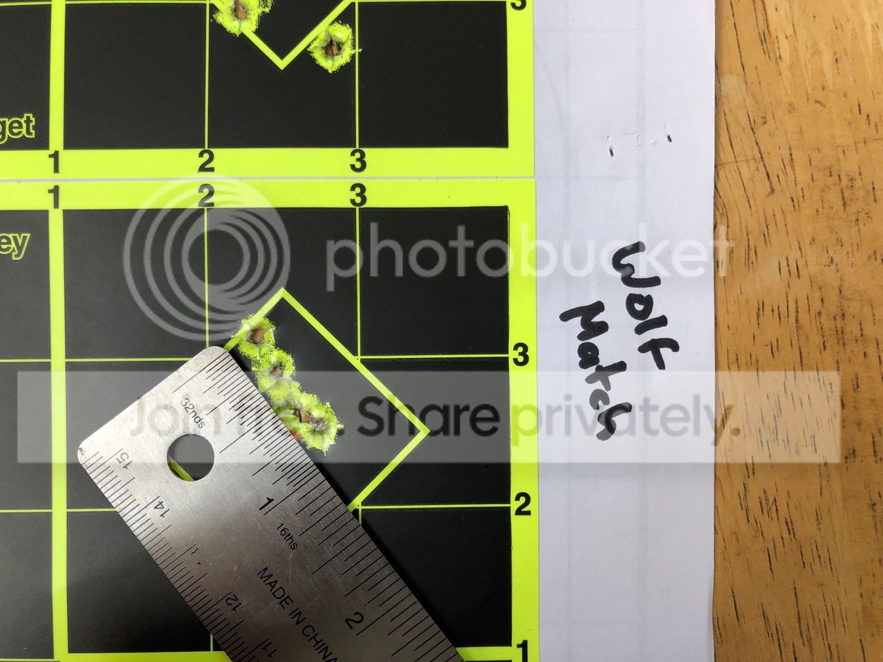

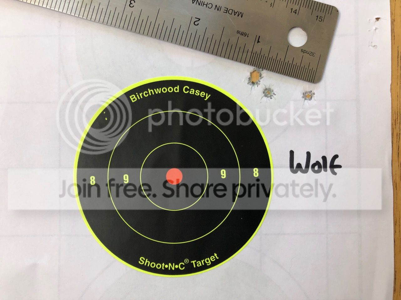

    Wolf Match: 3/4", second group 3/8"
    Eley Subsonic: 2 1/4", without flier 1"
    Federal Gold Match: 3/4"
    I made a mistake with the ammo and switched the Federal Gold match with the Eley. I'm calling the bottom left shot of the Eley group a flier, so corrected it would have a 1" group. I also reshot the Wolf as I was a little disappointed especially since I had to buy a whole brick and not just a few boxes at a time (Center of bottom target). Yes Federal gold match group was the same as the Wolf, so maybe someone might say I need to reshoot, I'm not that worried as I only bought one box and Wolf match is a little easier to find.
    Reshoot with Wolf
    We move on to 100 Yards:
    I wasn't expecting the CCI standard to outperform the others but it was worth a shot. I just used a free ballistics app and adjusted my MOA and shots were a little high. To be fair, I did not adjust my elevation after the first group of the shots.
    Results
    CCI Standard: 2 1/2" yikes
    Lapua Center-X: 1 3/4"
    Wolf Match: 7/8"
    SK Long Range match: 3/4"
    I was slightly disappointed at performance of the Center-X at 100 yards especially at how tight the group was at 50 yards. I might have to reshoot the Center-X but I did not have the time.
    Wolf match did well and will probably continue to be my choice of ammunition, until the SK Long Range Match becomes more readily available.
