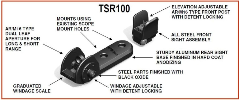

                    Garandimal
                    • Sep 2011
                    • 2145
                    Tech-Sights Model TSR100
                    Have these on all my 10/22's
