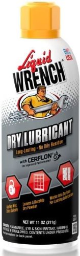

                    1) Crotchbrite the inside of the receiver for starters,
                    2) Scrub the chamber with Kroil or Hoppes and let it soak for 30 minutes and scrub again. Use a bent .22" or .243" (better) bore brush (use the thread end like a handle) from the breech.
                    3) Use very little oil; or better yet, use dry lube; or run the bolt dry.
                    4) Also make sure your mags drop free, if there's any binding against the stock, it can affect the feeding alignment.
                    What is the best way to smooth out the roughness inside of the receiver? I dont want to sand and grind away too much. Any good safe techniques out there? Pershing
