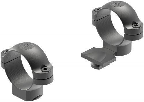

                        Leupold also makes extension rings. This set is for their STD mounting system, but you only need the front ring, which will fit your DD mounts. Maybe they offer them for DD mounting systems too.
                        Leupold steel Standard (STD) rings and bases are the most versatile of any mounting system we offer. This specific ring model fits an
                        Edit:
                        Midway has them in High Matte

                            Just an update for those who were following this or who search it in the future...
                            What I ended up doing was using the standard leupold rings and their Dual Dovetail REVERSIBLE mounts. There are two different ones for the same price.
                            After getting my first scope mounting debacle over with my new R700 is zeroed and is waaay fun to shoot
