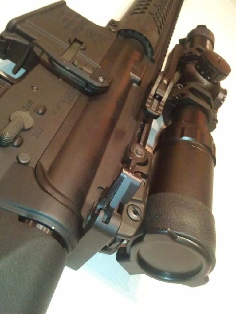

                        I originally had a Primary Arms 1-4x, but on my first outing it lost zero. So I sent it back to PA and upgraded to a Viper PST.
                        I haven't taken pictures of the Viper yet, but will here's a few pics of it with the PA scope.
