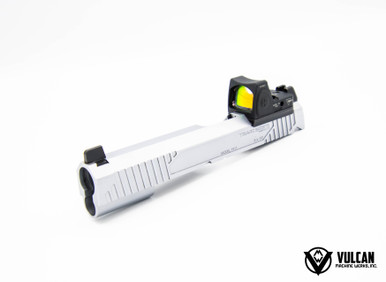

          Only hear great things about this company. Check them out for slide cuts!
          Discover Vulcan Machine Werks for top-tier firearm customization, laser marking solutions, and Cerakote finishes. Elevate your firearm experience with us.
