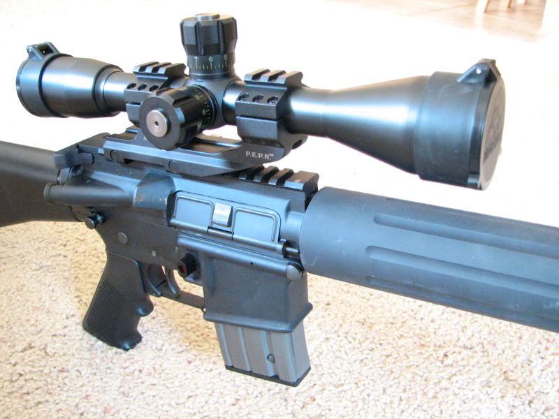

      Here's what I went with:
      Burris P.E.P.R. and a Bushnell 10X40 Elite 3200 mildot.
      WWW.SANTACRUZARMORY.COM

        I like it, looked at it, but would not work for me.
        Burris PEPR = the rings are to wide edge to edge to fit in my 3.2" of tube space to work with, plus it claims only 1.59" to center line, so just not tall enough
