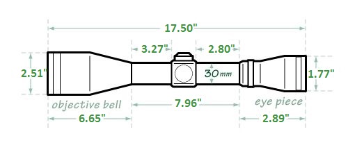

I am planning to install a Mueller 40x56 target scope on a Savage MKII TR. I will be using a 25 moa base from DIP. The scope is a 30mm. I would like to get it as close to the barrel as possible, but was worried about getting too close. Also, I want to make sure my math is right on how tall the rings need to be.
From the Mueller website, the following are the specs on the scope:
If my understanding of ring heights is correct, then the rings will need to clear at least 2.51"/2, or 1.255". DIPs' website says the 25 moa base is .31" tall. So would that mean the rings would then need to clear at least 0.945"? (1.255" - 0.31").
