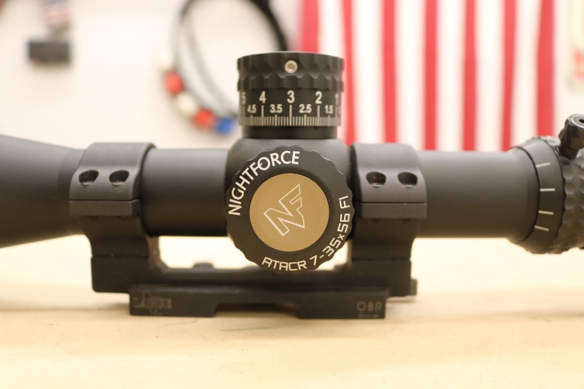

            Here's one of the guys we sponsor for PRS matches with his 7-35x
            And he uses 35x for the cold bore shots at 200 yards and have one it a few times this year:

                          Went to the 50bmg 1k match in Central Cali. The ONLY scope and I do mean ONLY scope being used on every rifle (over 50 rifles) was Nightforce. When I asked why they said it was the only one to take repeat 50bmg recoil and best no hassle warranty in case one did fail.
                          The guys there had tons of cash and could buy any scope made. They all owned NF's
