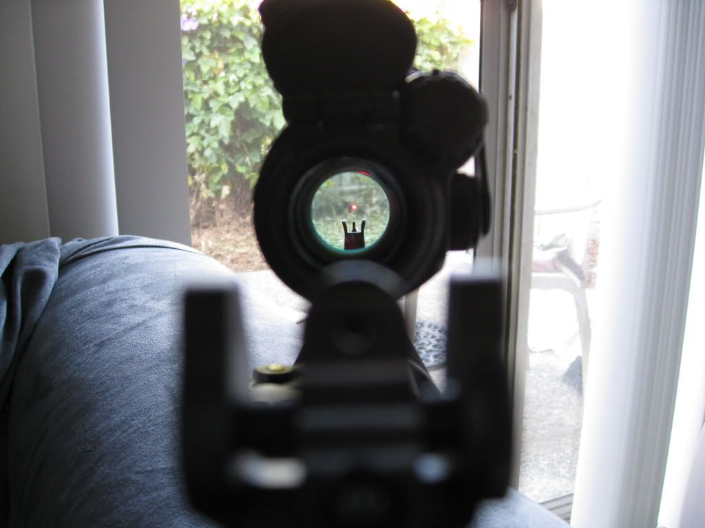

      Either the LT-129 or LT-150 from LaRue gives 1/3 lower co-witness. I don't think you could ask for a better mount. This is what my front sight looks like when looking through my aimpoint. Ignore the fact that I had the buis up when I took the pic.
        That's actually a perfect example of why lower-1/3 co-witness is great. You can use fixed irons with it and not obstruct the use of the dot.

            Cool.....I was hoping for a 1/3 co-witness anyways......thanks for the info guys. Looks like the Aimpoint will be good to go out of the box.

                    Hey....thats my favorite place to go.....Sunnyvale Rod and Gun Club. Cool people...no BS "Is that thing legal" questions. Nice picture.
                    So how is the sight picture different than that with the factory mount??
