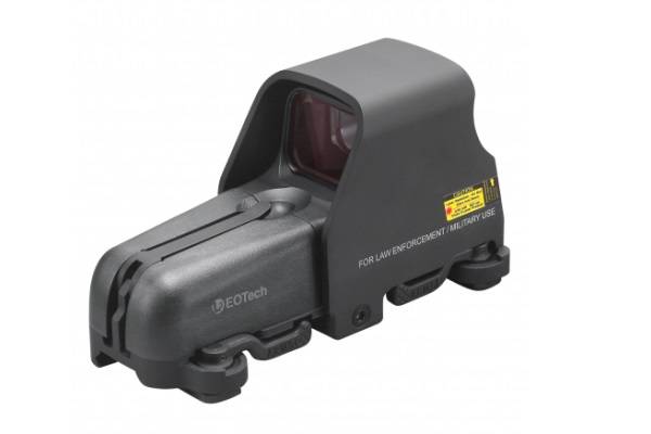

    For those wanting to know the specifics of thermal drift, a dude on M4C tested his EXPS 3-0 in an optics lab and this is what he found:
    I did a little experiment with my EO today: Screenshot_2015-12-18-12-09-33 by azoutdoorsman, on Flickr 2015-12-18_12-08-23 by azoutdoorsman, on Flickr 2015-12-18_12-07-15 by azoutdoorsman, on Flickr 2015-12-18_01-02-35 by azoutdoorsman, on Flickr No zero shift that I could discern. The front and rear lenses on the EOtech were a little fogged up from condensation, but it was on the OUTSIDE of the lens and wiped off easily. Sight was outside approximately an hour. Checking the zero against t...
    "so... interesting results.
    Model EXPS3-0
    Zeroed at 73,
    took it up to 125 confirmed with Infrared thermometer. Zero shift.
    took it down to 32 confirmed with Infrared thermometer. 1 1/2 MOA Shift. ended up at 1/2 MOA shift after getting back to 73
    Re-zeroed at 73, took it down to 40 confirmed with Infrared thermometer. Zero shift.
    took it up to 150 confirmed with Infrared thermometer. Zero shift.
    So I suspect the shift has to do with expansion and contraction. Could not really push the upper temp limit to see if I could get it to shift, our equipment only goes to 150."
