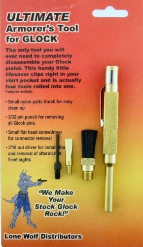

You'll need a 3/16" nut driver, Ameriglo makes a decent one:
Most any decent hobby store that carries tools for R/C cars is likely to have the nut driver, as well.
