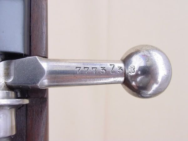

            Let's try this. If not I'll just post the link. This isn't the rifle, but its in the same configuration - bent bolt, straight angle, blued, and no stock cut-out. The rifle I'm looking at has most of the blueing left on the metal, much more so than this picture. Stock appears to be in about the same shape.

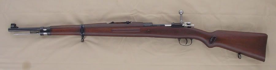

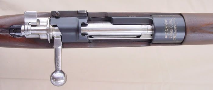

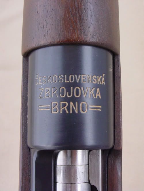

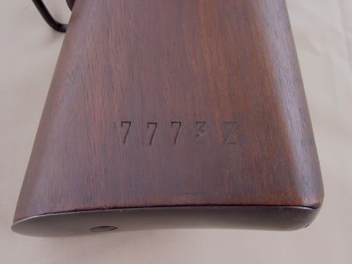

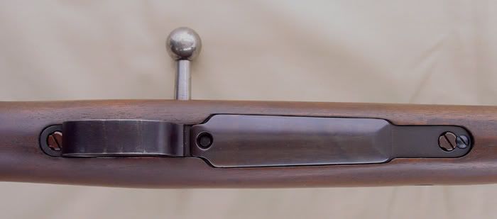

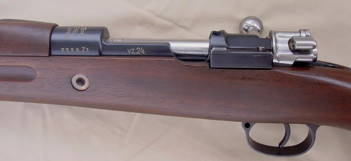

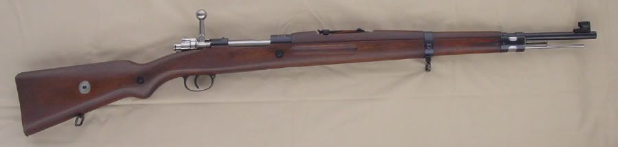

                Here are a few pic's of probably the best vz.24. that I have ever seen. I was lucky to get this one!!!

                  Does the number on the bolt match the serial number on the receiver? If the bolt is original to the rifle, the pattern of wear should be similar, and the font used for the serial number should match the receiver...

                    I just checked your image against my copy of Ball's Mauser book. From looking at the pictures it seems like the angle of the bolt does not match match a factory bent bolt. The only variant that has a finger groove stock and a bent bolt is the VZ24 high turret sniper variant.
                    My guess is that it was reheated and bent after it left military service.

                      You can usually get anything you want if you have the coin, but I will echo the fact that I have never seen a VZ-24 that nice offered at any price. For a variant that tends to be in rough condition most of the time, that is quite astounding.
                        Considering the sheer numbers made, you'd think it'd be easier to find Vz.24s in good shape, but it really isn't.

                              PS - SVT-40, that VZ of yours is incredible! Must be super-rare in that condition!
