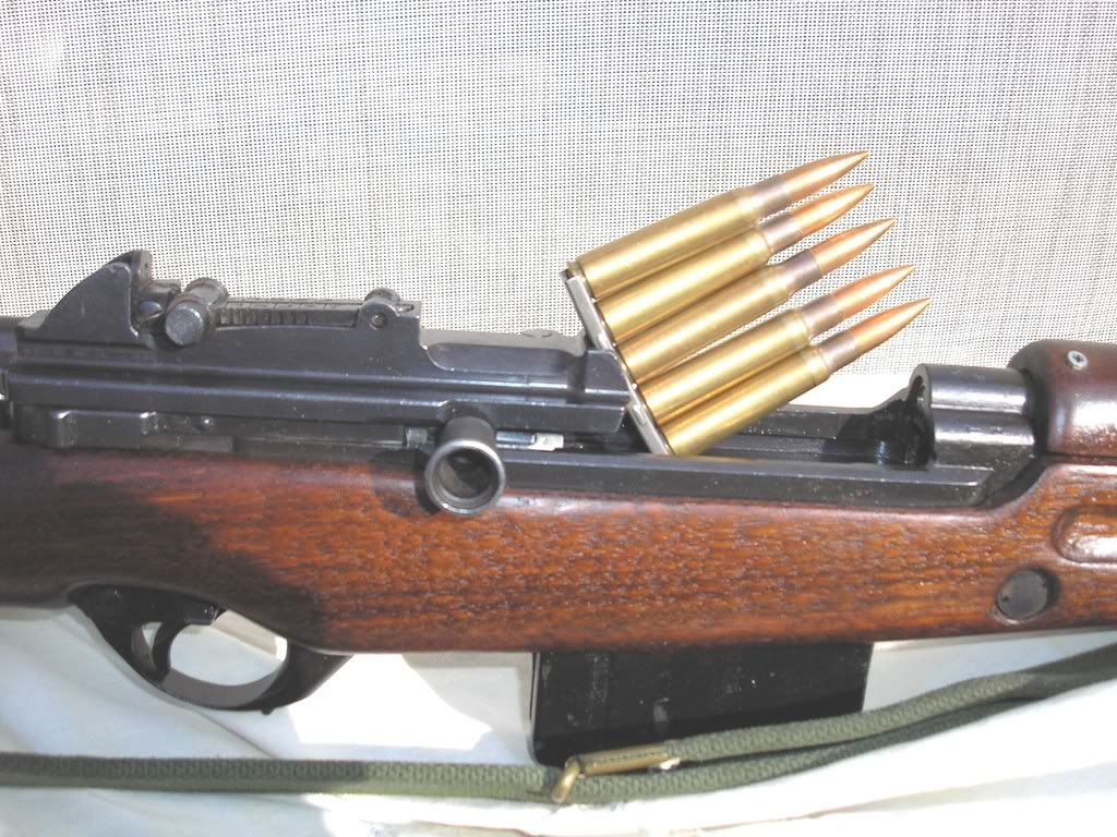

            That Yugo ball you got from me awhile ago will work just fine in a 49. You need some 2 bump clips for an Egyptian 49. Regular mauser type clips work but aren't correct for this rifle. See below for the reason. I've got some left from my 49 if you want them.
            This is what happens when you use the usual 3 bump mauser clips in an Egyptian issue FN 49. The clip doesn't sit in the slot low enough to properly strip the rounds into the magazine.
            This is with the 2 bump clips. The clip is inserted as shown and swung down to sit at the right depth to strip the rounds into the magazine. Then the clip flips up and out with either the flick of your finger or when the bolt runs forward. The same method is used with the Hakim.

                      It is interesting that several of the FN49s uses a different style of clip. The 8mm uses the clip that I showed in the pictures. The .30 and 7mm uses a clip that resembles an 03 clip (thicker cross section). Glad you like the 24/47!
