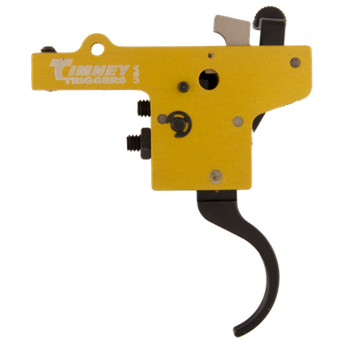

                        If you want to change the trigger one of these is pretty easy to do though you may have to trim the stock to get it in.
                        Shop rifle parts (2,583) at Brownells, including barrels, stocks, triggers, and bolt carriers to customize, repair, or upgrade your rifle’s performance.
                        The Mauser Featherweight Deluxe trigger features a trigger blocking side safety, making it suitable for most bolt-action rifles with Mauser actions as well as Husqvarna and Mark X actions.
