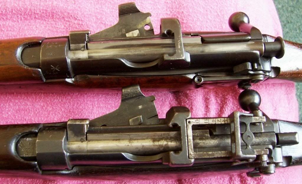

                The MkV cutoff differs from the MkIII in not having a "spotting hole"
                MkIII top, MkV bottom.
                  Enfield47
                  • 6385
                  Mine is definitely a Mk V cutoff, it has no spotting hole.
