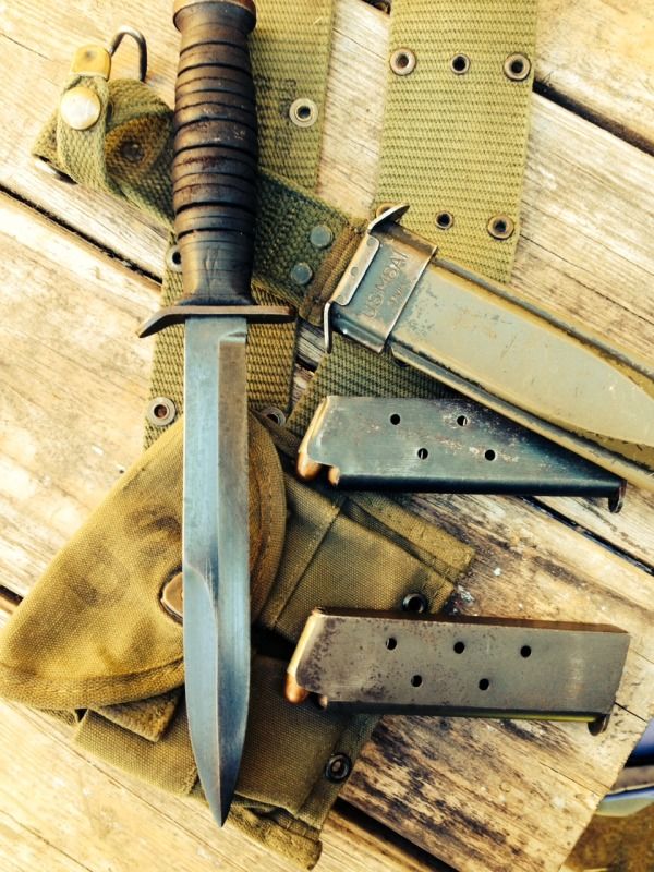

    Found a really rusty dagger on Craigslist for $30
    (Listed as a "ceremonial dagger"????)
    A few nights with 0000 wool and oil, and a little non invasive - TLC.
    I will try to find before pic - it was definitely not a keep in as found condition type of thing!!!!
    Nice flaming bomb and star lines around pommel.
    US M3 Utica - under curved down guard.
    (No blade marking, as is correct of later model.)
    Eight groove leather washer grip - The Utica pommel is not pinned but hammered down so cannot replace them, and don't care, I like it worn in looking.
    The blade was parked, but, heavy rust (and a home sharpening session with what looked like a granite boulder many years ago) had removed it, and blood or water damage - blade is now cold blued until I find a nice way to replicate the park.
    Found a salty M8A1 scabbard here on Calguns -
    Sometimes this stuff is as fun as finding a old gun.
    In fact I may just get another WW2 1911 to go with this
    Yes - I know Utica didn't blue their blades, but, it's a light layer of cold to keep it nice until I find a way to park without removing leather. That and a park that looks right
    Unreadable under gunk when I found - this is original finish -
    Flaming grenade - hidden under heavy rust when I found.
    M3 dagger wasn't quite as action packed as people would like to think, it was simply issued to GI's who's sidearm could not accept a bayonet - still one of the cooler items of GI gear.

        Grind the preened over end on the pommel and replace the leather washers minus one or a thin one then repeen it.

            nice find. keep your eyes peeled for the correct M8 scabbard. nothing wrong with those washers- for certain don't grind the pommel.

              Ref. knife - done with this one, unless I find a good parkerizing solution - but, really don't mind the blue - it is what it is.
              The washers are old, but very solid, and fine for use - I like the initials carved in -
              Post your restored US military knives here - I'd like to see -

                I once found an old K-Bar with horrible leather. Looked a lot like yours. I soaked the grip in a jar of mineral oil for a few days and "rejuvenated" (for lack of a better word) the leather. Don't know if you want to try something like that or not. I was young, dumb and didn't know any better. It did happen to work...

                  Why not he already blued the blade the knife is not original, I would try the mineral oil thing but if the washers are like mine were, they just crumpled in my fingers, then I'd disassemble it and make it usable. Just my .02 cents.

                      Nice cleanup job Pit. Here's a DIY parkerizing that may work for you - http://www.projectguns.com/parkerizing.html. I don't know anyone personally who has done this, but it does look intriguing.
                        pitfighter
                        • 3141
                        Thanks Enfield47 - it's a very specific color and thickness of park for these - close to the 1911 mag on top in the first photo.
