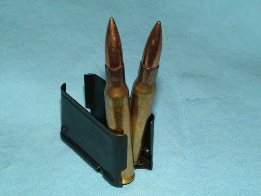

                    It takes two just fine.

                        Cartridges need to be fully back, seated against the rear of the clip and the top round on the right. That gives a more positive grip when "thumbing" it into the rifle.
                        In the National Match Course of fire, it's "two and eight" for rapid fire, and I always loaded the two with an en bloc clip dropped into the magazine well. Some genius made two-round clips, but it was just easier to load the two into the rifle -- preparing for the first string you always had more time to get ready anyway.
                        My M14/M1A works just fine with "two and eight" though sometimes I forget and tap the back of the magazine on my helmet (when I'm not wearing one) and cause (more) brain damage.
