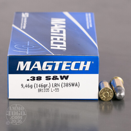

                  Very happy to hear that you rescued that poor abused pup and plan on letting her run around the yard a bit. Here's a link to the cheapest ammo I could find with my search-fu.
                  Cheap Magtech 38 Smith & Wesson (S&W) ammo for sale at AmmoToGo.com - 50 round packs of Lead Round Nose (LRN) 146 Grain ammunition in-stock now.
                  Be sure to let us know how she does!

                      Marquand, thanks for the link, that's the cheapest I've seen it!
