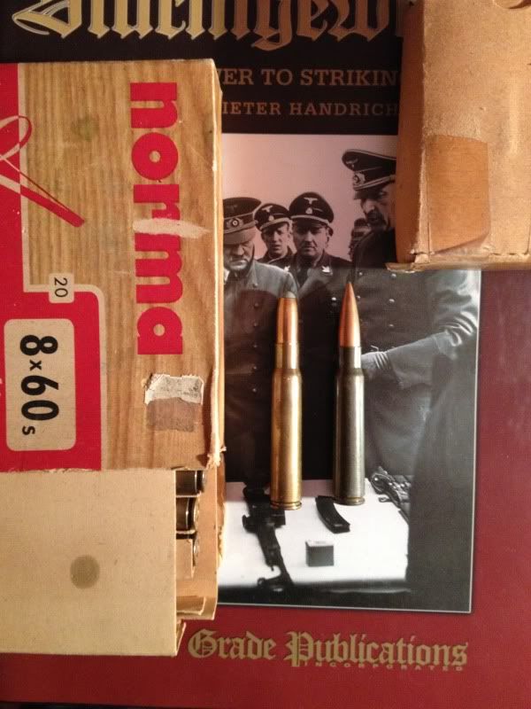

          I picked up some old norma 8X60s ($10 for a box of 20 ) at the Santa Barbara show - it is definite no go on the Mauser Sporter.
          I think it is 8X57 and just needs tuning and correct head-spacing - the bolt appears to be an unnumbered replacement, and could also be the source of the problem.
          *I fired three rounds of 8X57 they were just very stiff (read required a plastic mallet) to chamber and eject.
          It was worth a try - the Mauser needs to go get a professional tune up and service - still looking for a great Mauser smith - it's a beautiful little rifle and deserves a second shot.
          In the meantime I learned a little about interim war German sporter calibers, which is never a bad thing -
          An 8X60s next to a wartime 8X57
