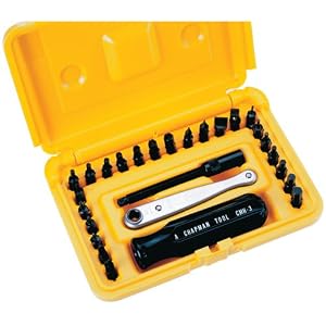

          A set of hollow-ground gunsmith screwdrivers is ESSENTIAL for working on firearms. I use one of these sets from Chapman
          What is great about the Chapman screwdriver sets besides the price and the fact that they are Made in USA is it includes a ratchet handle that slips over the screwdriver shaft. It allows you to apply downforce (by pressing the screwdriver into the screw) while applying a lot of torque (with the ratchet handle) at the same time. It works great for loosening tight screws without buggering up the screw slot.
          The bits are designed to break before they bugger up the screw head. Replacement bits are very inexpensive, I order several in the smaller more delicate sizes.
