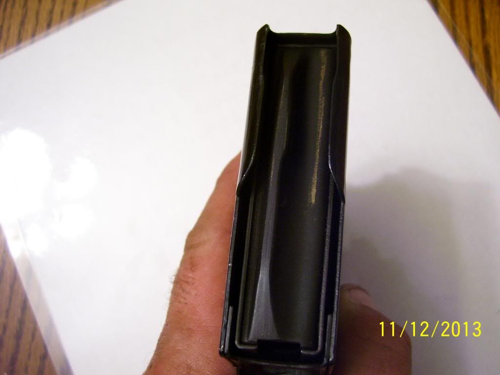

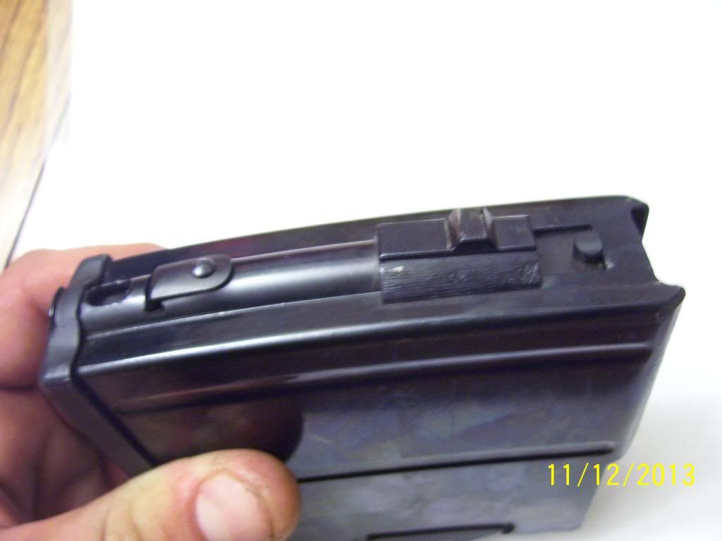

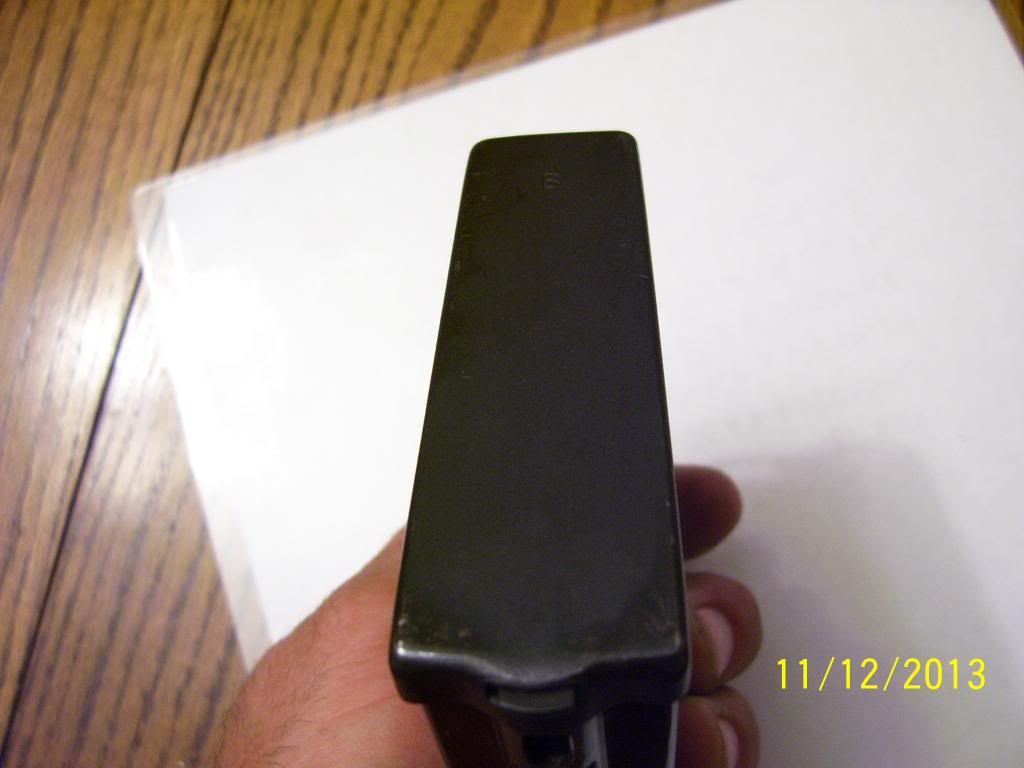

                  So I couldn't figure out how to measure the feed lips on the magazine either so those pics are not coming. The feed problem MUST be a magazine issue though right?
                  Is the magazine supposed to have these nails in it?
                  ljungman magazine by Glamisduner, on Flickr
                  Not sure how to solve this feed issue. Should I bend the feed lips up?

                        TRAP55
                        • Jul 2008
                        • 5536
                        In hand, I'd have it figured out in 10 minutes. From a keyboard, it's doable, but a PITA, so bare with me.
                        Cartridge length has to be within specs, there's not much room for error there.
                        With that suspect eliminated, there's several reasons the bolt will fail to pick up a round.
                        1) The bolt is short cycling.
                        Cause: Dirt in the bolt assembly, plugged or fouled gas system, or too low chamber pressure reloads
                        Fix: Clean and lube, find a load that duplicates factory chamber pressure
                        2) Weak magazine spring
                        Cause: Old spring and/or left fully loaded over a long period of time
                        Fix; new spring
                        3) Follower hangs inside the mag body
                        Cause: Dirt/rust, dings, burrs on the follower
                        Fix: Clean and "lightly" lube, de-burr follower and inside of mag body so follower moves freely
                        4) Magazine not fully seated in mag well
                        Cause: Worn mag catch, mag not fitted properly, mag feed lips too high interfering with proper seating
                        Fix: Replace catch, fit mag, adjust feed lips
                        5) Mag feed lips bent down too far in the rear, not enough gap between mag lips for the cartridge rim to come up for the bolt to catch it
                        Fix: Usually find this on aftermarket mags. Usual fix is filing the lips to a wider gap. failing to feed from one side is usually the lip on that side.
                        Mag lips are the last thing to mess with.
                        One of those "nails" on the bottom of the mag should be a floorplate release to disassemble the mag for cleaning. Push in on it, and slide the floorplate over and off of it. Pay attention to how the parts come out, and re-install the same way.
                        Clean, lube, check for burrs and free movement.
                        Get a pic from the top, of a typical misfeed in your rifle, that will show me what's going on. Another pic, same area, closeup, with empty mag fully seated.

                          I don't think it is the reloads because it will not even pickup the 3rd round when I cycle the bolt by hand. Mag not being seated was the first thing I checked, it was certainly seated. When it failed to feed I took the magazine out, moved moved the rounds and follower up and down, re-seated the mag, and it still failed to extract the round.
                          I'll try taking the magazine apart as that is one part I did not clean.
                          I have a feeling it may be a worn magazine catch though
                            TRAP55
                            • Jul 2008
                            • 5536
                            The mag should lock up tight when seated. If it's loose, next time you shoot it standing, support the front of the gun with the mag. If it functions, there's your problem.
                            It may be the mag, the catch, or both. The newer style mags have an additional catch on the front and lock up tight.
