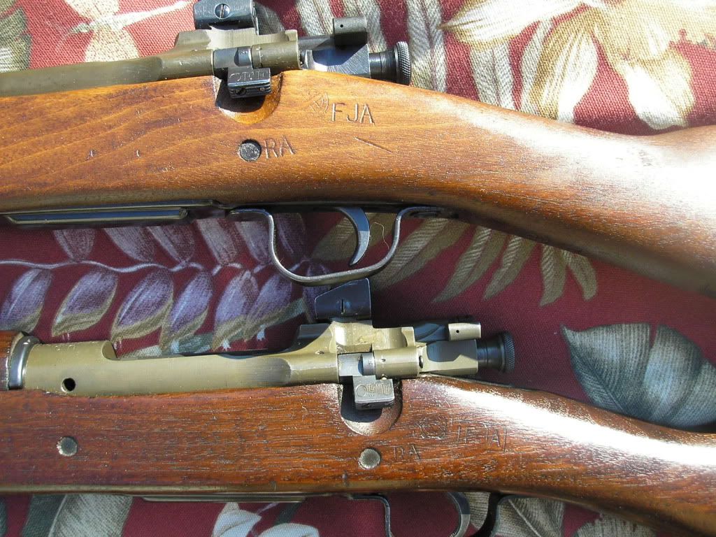

                      Stock stamps on two of my 03A3s. The bottom rifle in the first picture was sold off. The stock had been heavily BLOd. The 404 series rifle is the one with the late date 4 groove barrel past the date usually considered the change over to 2 groove. Perhaps the barrel had been made up but not finished until later when it was date stamped? Since it had an SC bolt shroud I think the rifle had gone through an inspection and repair even though the stock wasn't so marked. It also came with a Boyt 1943 dated sling. Who can say what happened so many decades later! Wish I had kept it but at the time I wanted something more than I wanted this rifle.
