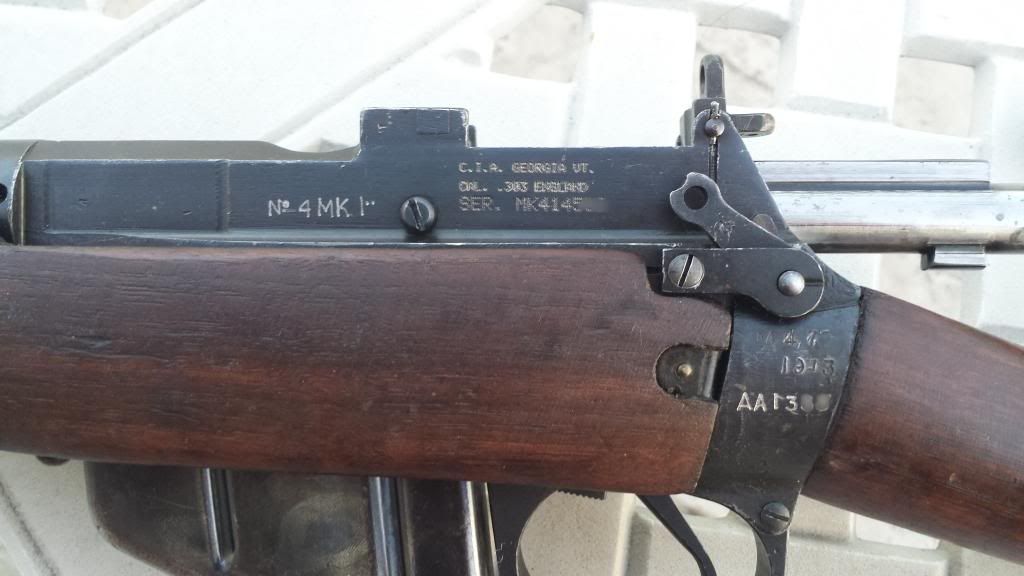

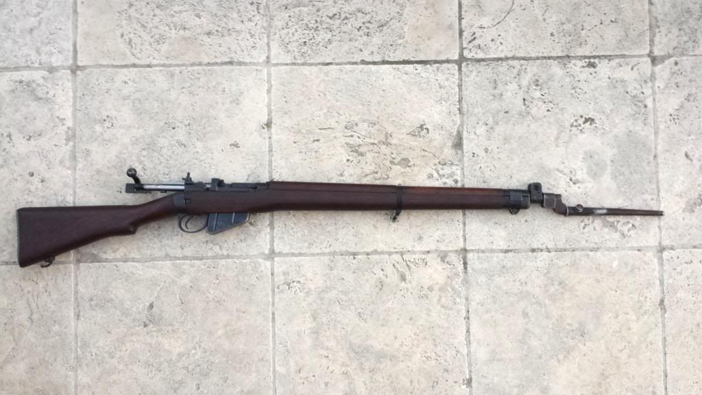

    I recently picked up a No 4 Mk1 not too long ago, but I'm clueless when it comes to C&Rs. Anyone have any info on what I have?
    No ZF marks on the butt stock, or DP. No FTR markings anywhere.
    M47 marked. Birmingham Small Arms? Under M47 is 1913? Then Serial #

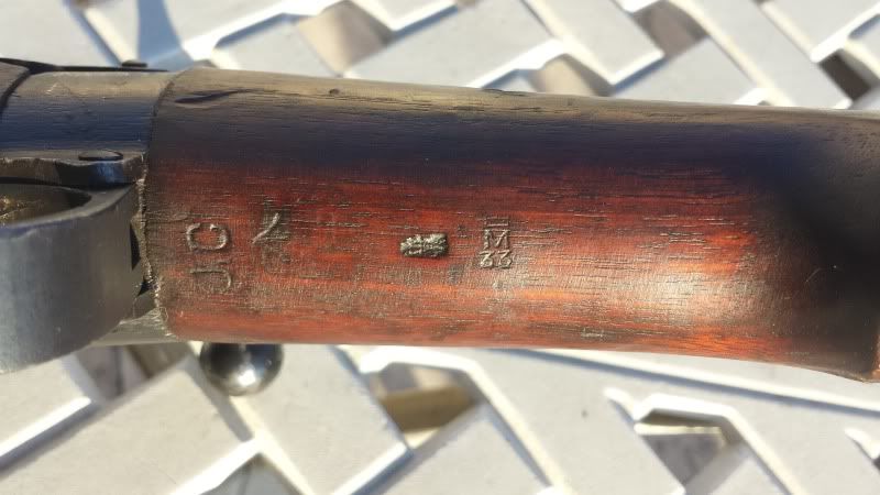

    Marked JC, then an arrow pointing up, then a unreadable mark, lastly M33 with M ontop of 33

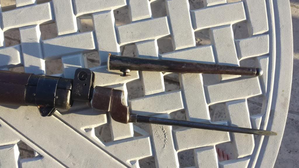

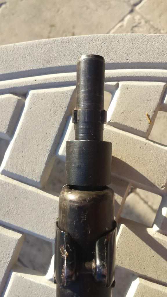

    Correct Bayonet?

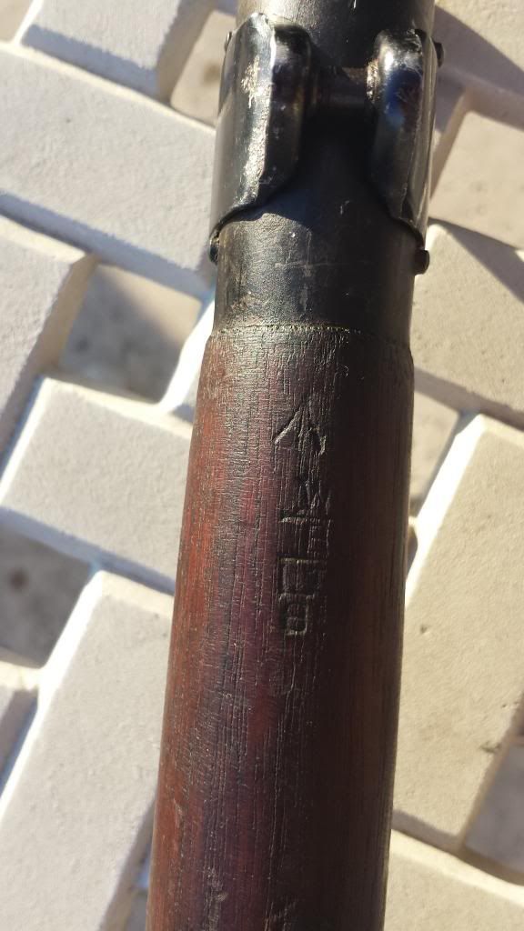

    Next to the band marked WL
    Arrow pointing up, then W, B, L, 8

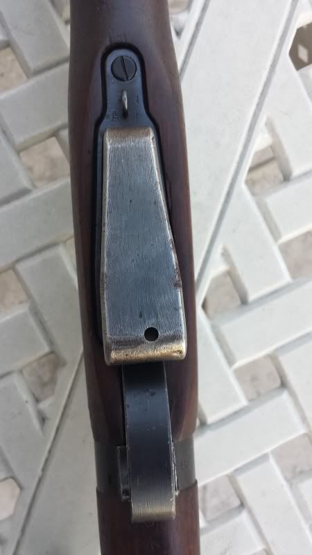

    Floorplate marked A, P

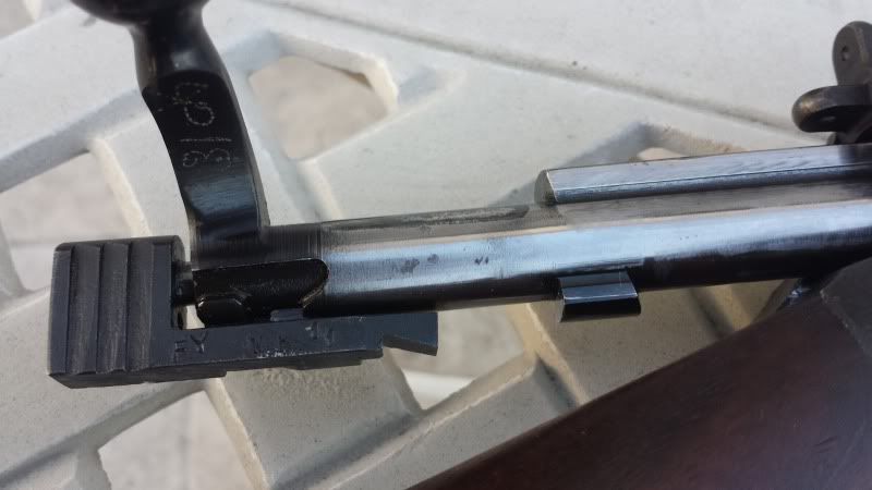

    Bolt marked FY, MK 1 1

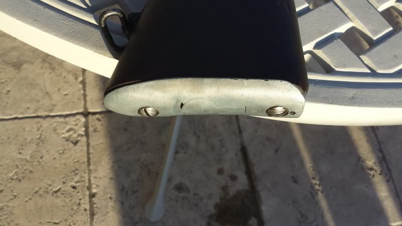

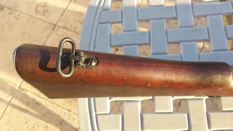

    Correct buttplate?
    thanks

    I only have one and don't know that much about them, but I have a book on them.
    According to the book, the AA0001 through AA9999 is BSA-Shirley manufacturer. Also the M47 is the mark for Shirley as well.

      Nice #4, mid war production, zamak buttplate, Mk2 flip sight. The sighting range was adjusted by fixing or removing the bayonet to split the difference between the two ranges marked on the leafs. Two groove or five groove bore?

          The various markings that you show are the subcontractors who made the parts and pieces that were assembled into the complete #4 rifle.

            On the receiver after it says No. 4 MKI there are two dots. Do those dots mean anything?
            "All bad precedents began as justifiable measures." Julius Caesar
              Enfield47
              • 6385
              I was wondering about that too. I just glanced through my Enfield book and didn't see anything noting two dots after MkI.
                smle-man
                • Jan 2007
                • 10580
                I've never seen it before and I'm assuming the electropen skipped while doing the markings.
