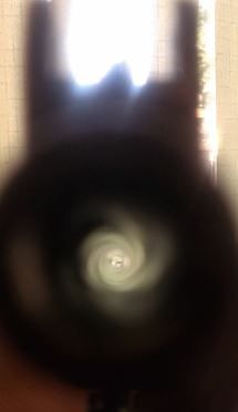

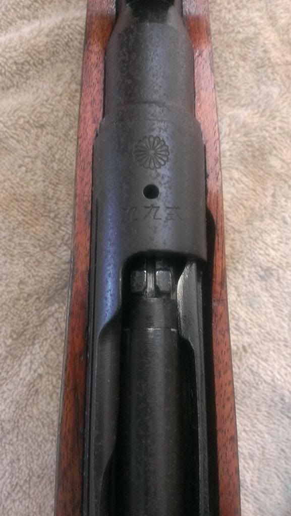

    I have one of these my grandfather gave me. The chrysanthemum is intact, but the gun has some rust on it. I'm also missing the safety knob, firing pin/spring, and the follower/spring. There does appear to be some pitting in the middle of the barrel, but I haven't finished cleaning it up, so I'm hoping it will clear out.
    My question is, can this gun be refinished, parts replaced and still hold some of its value? I don't plan on selling it ever, but curious. I dont believe the rust will clean off without removing the underlying finish. Some spots on the outside of the gun do appear rough and there is some pitting, which I image are from the rust.

    Parts are available everywhere at gun show parts boxes and over on gunboards rising sun forum, Safety's are usually not compatible and fitting the safety knob is a bit tricky.
    You can use a Remington/savage follower spring but may have to do some grinding of width. Might be able to mod a long action follower to fit.
    For general cleanup get some bronze steel wool from ACE/Ochard/home depot and wet with wd40 and scrub away.
    Don't refinish stock if your allergic to poison ivy/sumac as that was a base ingredient (Color) originally for finish.
    Brass can be made out of 3006 brass then shortened to length, dies are everywhere at gunshows.
    If you refinish your stock value will go down approx. 33%, most arisaka's are mismatched and are approx. 33-50% higher in value if all matching and intact mum.

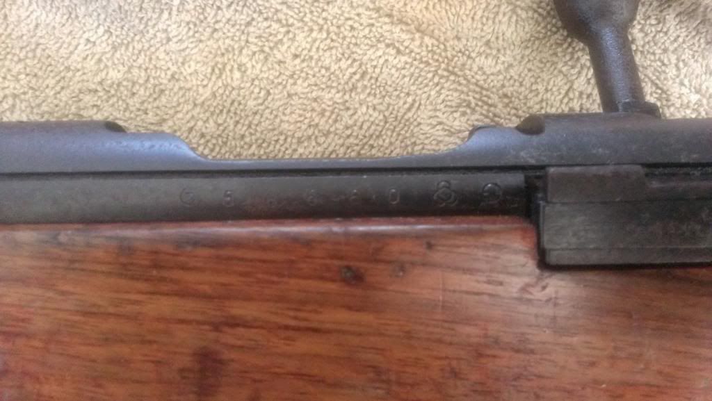

          That's a 32nd series Toyo Kogyo made in 1943, Hiroshima.
          I would strongly advise not to refinish anything. In addition the screws are originally staked and best left staked if you haven't pulled it apart yet. Does the boltbody have the same digits as the last 3 on the serial? (match)

            yes, the bolt has 660 stamped, and that is last 3 digits on the body. I'm missing the original firing pin, spring, thumb safety, forwarder and forwarder spring. They got lost over the years. I thought I remember a rod near the front of the barrel - there is a hole for it, but I dont see it on some of the parts list.
            As I'm wiping the rust off, the finish appears to be going with it somewhat. The gun has been disassembled (it needs a really good cleaning), what do you mean by staked? Why do you suggest not finishing? This will never leave the family, so we are not too concerned with "collectors" value... however, if I can get rust off and still have it look halfway decent, i probably will not mess with it further than that.

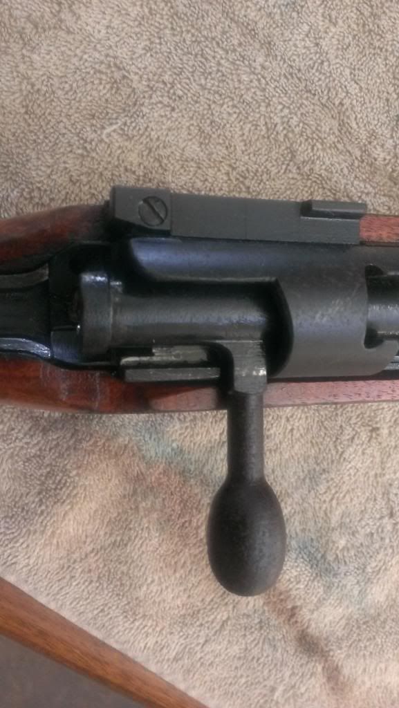

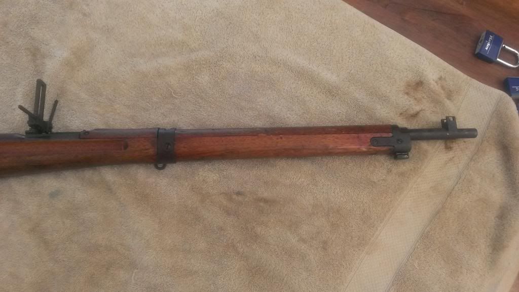

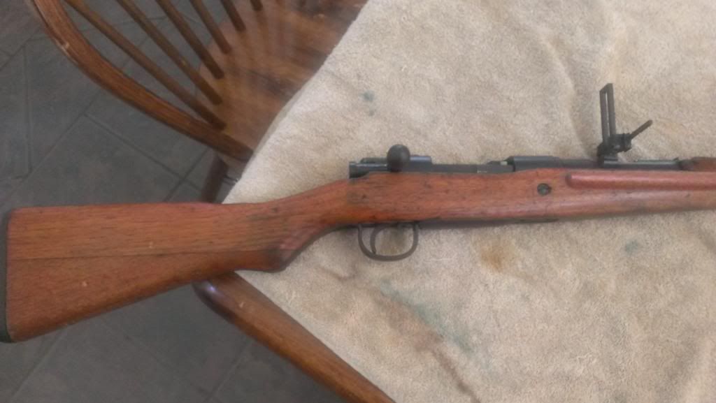

                    thanks guys for the advice... i just used some bronze wool with some wd40 to get the rust off (somewhat) and it looks a lot better. I'll keep it as it is. Now, I just have to get some ammo to shoot it... the small pit in the barrel is looking better each time I give it a scrubbing, so I'm hoping its just surface rust.

                      See, no refinishing needed. Its looking good.

                        looking much better already, well done. I just poked around and everyone seems to be out of 7.7 jap currently. looks like a good time to start reloading!
