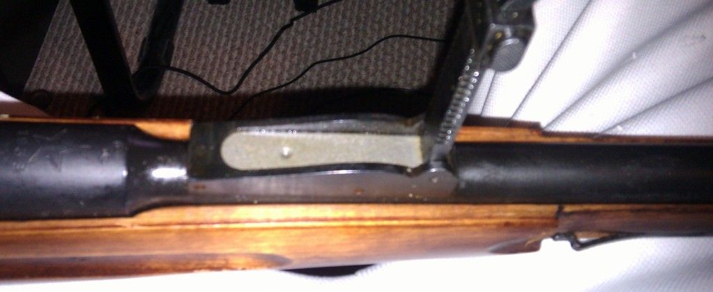

                  SailorDave
                  • 20
                  Ah okay. I was looking for a coil spring. That leaf spring looks familiar. The only difficulty I've had with fixing it in the field is when the sight ladder torques to the side I have to hold it down to get the holes to line up. Then like I said just a quick tap with the butt of my knife and I am back in buisness for another 15 to 20 rounds. Its beginning to seem as if the spring has lost its tension. I will disassemble it when I get home and snap some pictures. Thank you so so much for all the help you've provided me. Not to go off on a tangent but this rifle is the first gun I ever bought and I got it a little while after I turned 18 so its always been special to me. It is a great relief to know it will be working properly again and also to get some knowledge. I really can't say enough nice things about Mr. Smith.
                  Guns don't kill people, physics does.
                    SailorDave
                    • 20
                    Okay I took the pin out, and it was pretty tough to get out, but the spring appears to be intact and is quite stiff. I see what you mean about the pin only going in a certain way, I tried hand fitting the pin in the sight so that it wouldn't get lost and lo and behold it only goes in one way. So that's good to know it is relatively idiot proof. I took some pictures to show the spring.

                      Josh Smith
                      • May 2011
                      • 1101
                      So, it looks like your spring is in good condition. Just slop in the holes. Be looking for a sight and base the beginning of this coming week!
