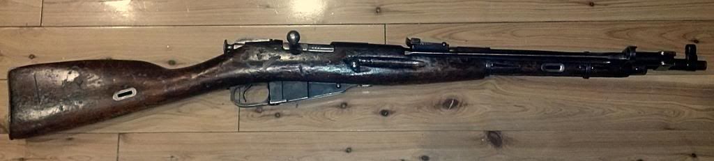

    Inspired by the cool rifle Ditchdrift received, I placed an order and just got mine. It appears to be in even rougher condition.

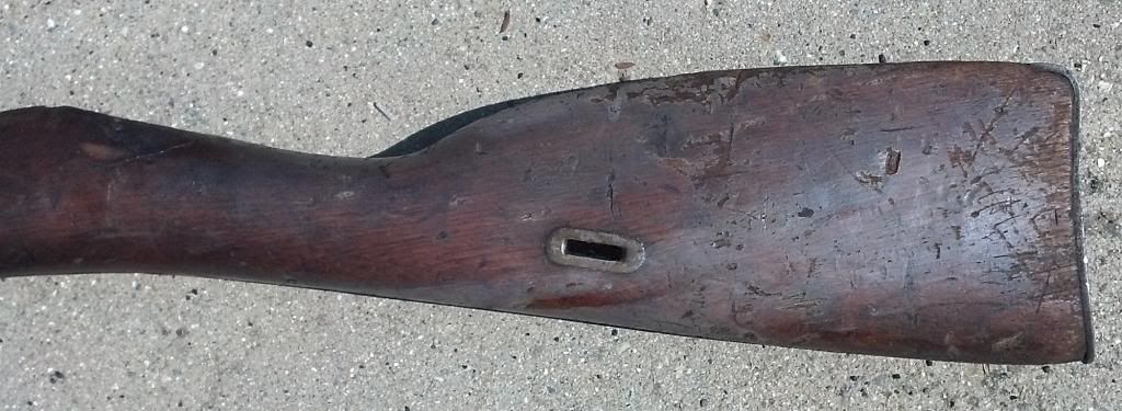

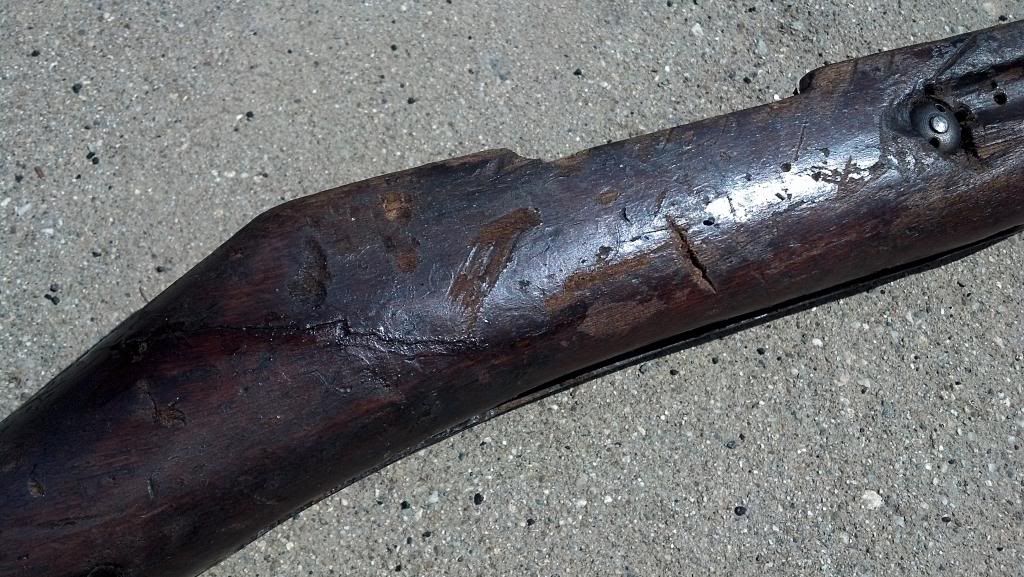

    C.A.I. import marked 1955.3 with the stock cracked at the wrist and bayonet relief, covered in deep gouges, scratches, very little varnish on the wood and what's left is milky, the metal is pitted below the wood, etc. All that and no cool termite damage!
    Non matching bolt, but the receiver matches the magazine bottom plate and butt plate.
    Here are some before pics.

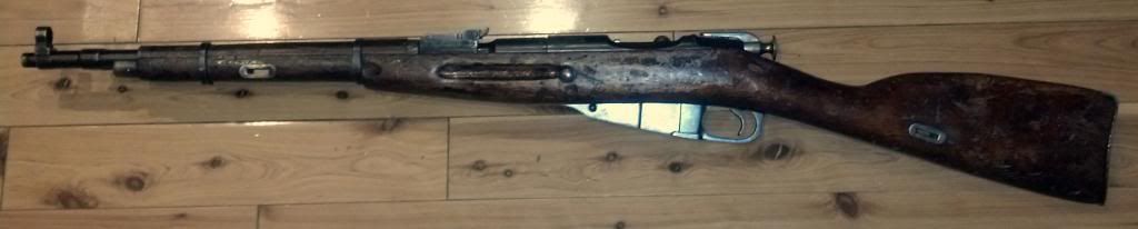

    These ARE the after pics. I know, it's still really rough but I got rid of the milky varnish, cracks, and splinters. It was meant as a starter rifle for my brother-in-law, and there was no time to buy a better stock, so I HAD to clean it up before gifting it.
