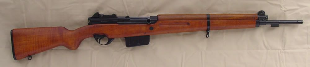

    I'm looking for a source of reproduction stocks. Specifically, an Argentine FN49. Don't get me wrong, I love the beat to hell look but I also like pristine as well.
    So I just wanted to see if anyone knew where I could find one and restore it to its former glory. Oh, and I'll re-blue it too.

    I don't think anyone is making repro stocks for the FN-49. Your best bet would be to find a ex Belgian stock and use that. They are still around.
    I used a ex Belgian stock when I built this rifle.

      Cool, thanks for the info. How much work do you think it would be to make it fit the Argentine?
        SVT-40
        • 12894
        Since the Argentine rifles have the cross bolt type stocks it should only be a matter of in-letting the wood to fit the Argentine made lower trigger guard/mag catch assembly. Easily doable.
