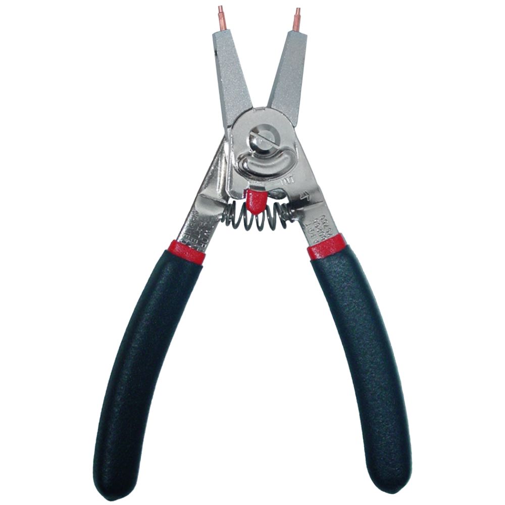

        Some quality snap ring pliers make it relatively easy. I bought a pair from Sears for snap rings but have used them a lot more for spreading things like the hood and also for removing some cross bolts from surplus rifles as they have the nut with 2 holes in it.
        The advantage of snap ring pliers over normal pliers is ease of use. You squeeze the handle to spread the jaws so you only need one hand for that and one to hold the rifle steady.
        Mine is like this and I'd recommend them:
        And no, $35 is ridiculous. Hopefully he thought you meant the whole front sight. Snap ring pliers are cheaper.
