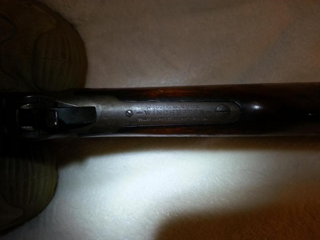

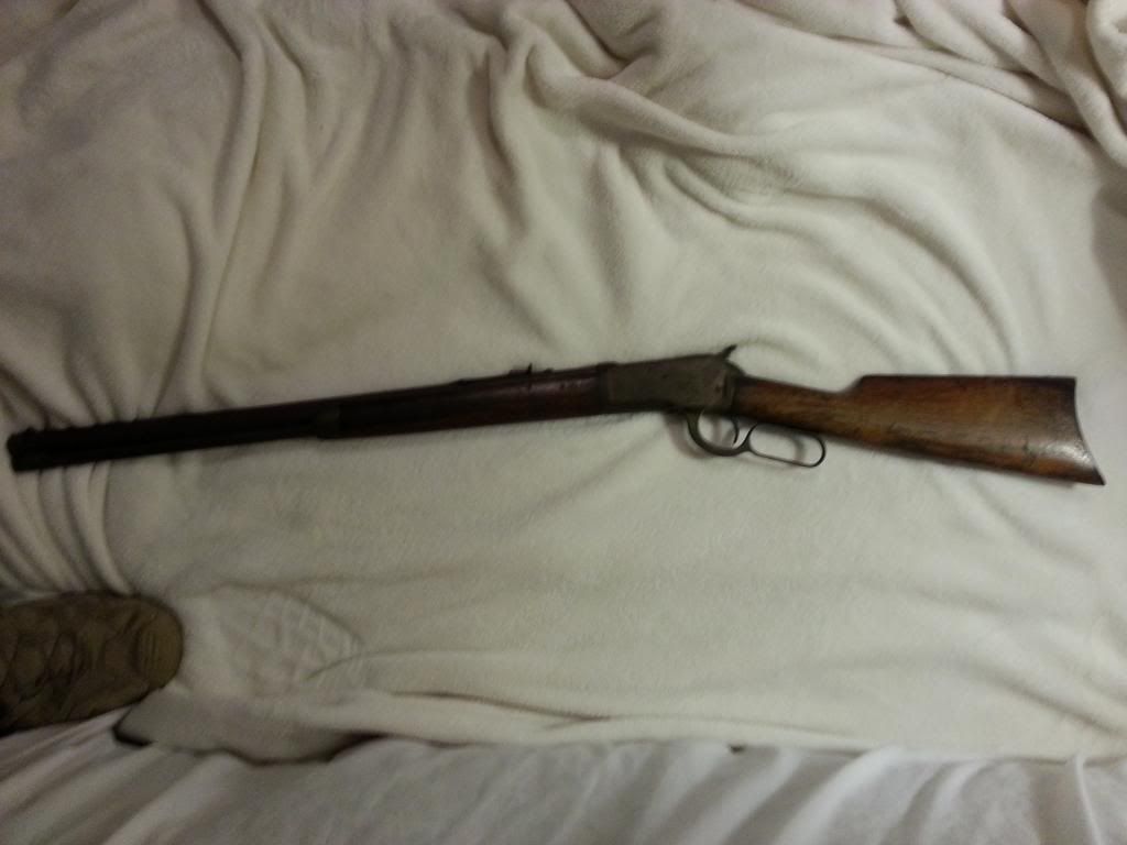

    Help me identify and age this gun. Its a Winchester chambered in 25-20 it says 1882. It is pretty rusty. I would like to know the value, if I should restore it (no not myself with steel wool) and options on restoring. I really want to shoot it so a little info on the cartridge and what to use ( I am a reloader).
    Make/year?
    Value?
    Restore/leave alone?
    Cartridge?
    Thank You..

    Looks like a model 1892 to me.
    If it has a serial number on it, Trap55 has a thread going on here (it's really long, shouldn't be too hard to find) where he's dating various winchesters. You might want to post the number in that thread.
    Here's the caliber: http://en.wikipedia.org/wiki/.25-20_Winchester

      DON"T do any re-finishing! Preservative cleaning only! Post your serial number on that thread link, and I'll date it for you.

        You have helped before (Great CGer) What about the rust, its pretty prominent, and what oil do you recommend for relics. I know CLP has a long term oil. And anything else you would recommend doing. Thank You.

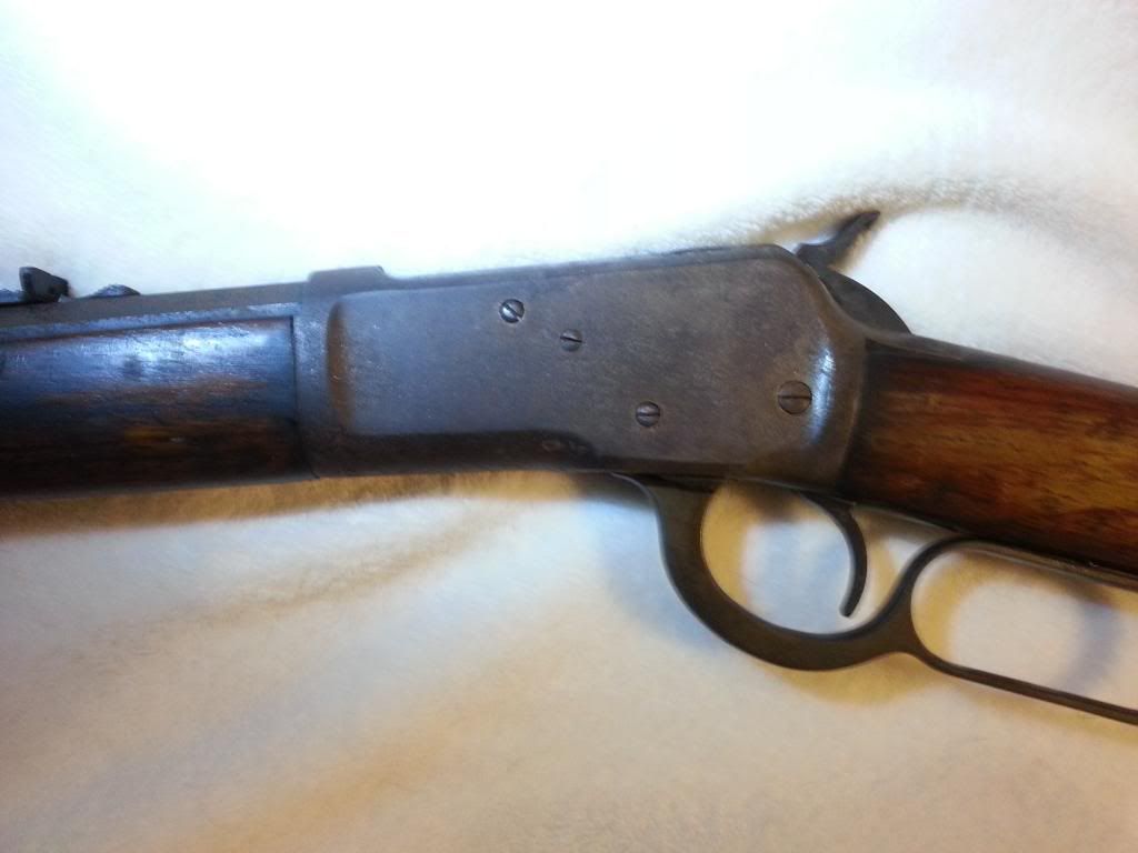

          Bronze wool and Kroil on the rust.
          Get a good set of hollow ground gunsmithing screw driver bits to pull the wood off, buggered screw heads are a value killer. Looks like most of the original finish is still on the wood, I would rub all the wood down with a piece of burlap dampened with linseed oil, and wipe the excess off, almost dry.
          Get a bronze bore brush and some Hoppes in that bore. The .25/20 transitioned from black powder to smokeless, and we both know it's had BP shot through it. If you still have a decent bore, they are real tack drivers! Neat little round to reload for.
          Made in 1919.

                            Hard to tell from the pics, and no "after" the clean up pics. Just a WAG, $600-$900.
