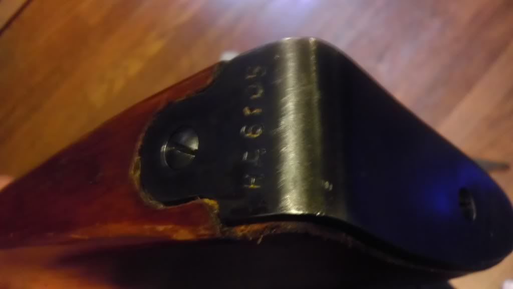

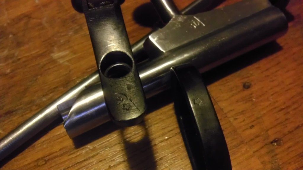

    The bolt, magazine, and rear handguard ring are stamp with the Tula star

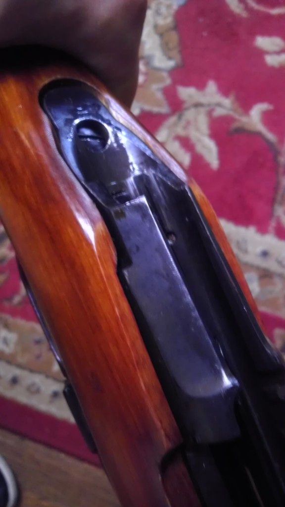

    The magazine plate was crossed out and re stamped with the correct numbers (forced matched)

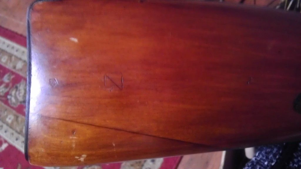

    The stock was in correct in my belief because I have a stepped rear tang and the stock looks like its for a 41' and younger round receiver
    On the rear of the stock it seems like the cut and replaced the rear portion

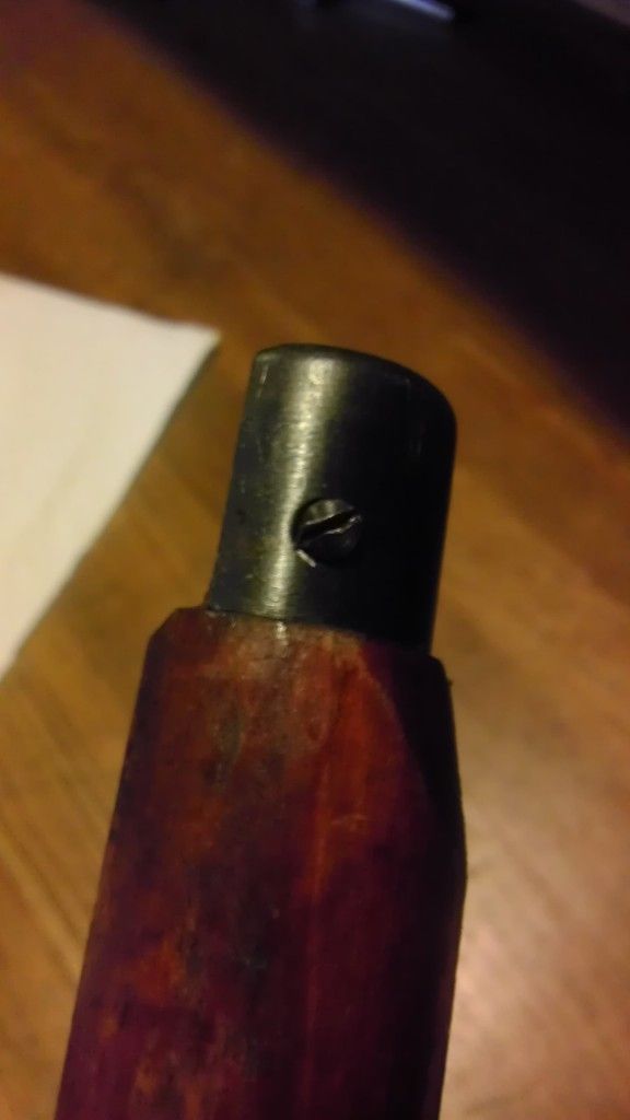

    The front of a stock has a screw on the cap? Is this normal?

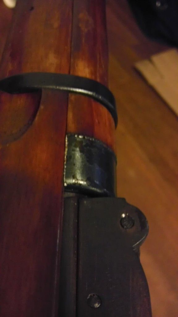

    It seems like who ever refurbished this mosin spray painted all the caps (I think that's what it is called please correct me if I'm wrong) over the original blueing even the rear butt plate. I had to 0000 steel wool most of it out, and will continue next time.
    Well at least the front hand guard ring, sight block spring, bottom of the receiver, and 3 pieces of the bolt have the Izhevsk mark

                        you have a double dated MO stamped mosin nagant. put it away and do not bubba this good example. when cleaning it the screw on end cap can be screwed into the cleaning rod nut and used to grip and remove it to get cosmoline out of cleaning rod groove.
