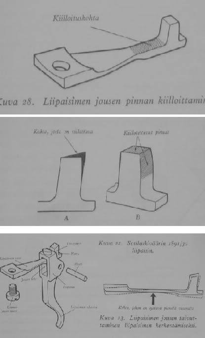

                        Check the rear part of the sear where it makes contact with the bolt knob. Has it been shaved down (sloped instead of flat) like a Finn sear? If so, you can probably just get another sear.

                              The diagram above is excellent at showing the sear angle. Stock trigger, it is very positive. ( i meant to say positive engagement in my orig post, duh) Sometime they're stoned to neutral or negative engagement. If the creep is taken out by a shim or bending this can be a bad combo.
