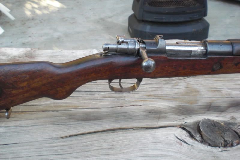

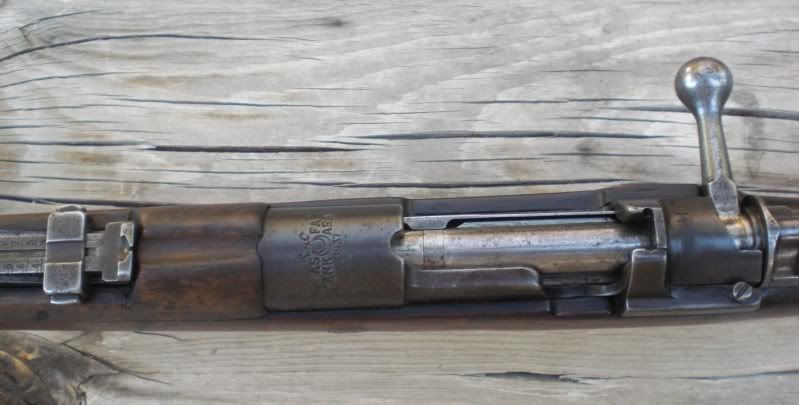

              I was actually asking about my new Turk Mosin, here is an image of it.
              See that wood? I know there is something beautiful underneath all of that grunge and I would like to see it without refinishing it. Recommendations?

                LOL... somebody ripped you off, that's not a Turk Mosin!! J/K
                If that turk MAUSER belonged to me, I would probably wipe it down with a rag soaked in Mineral Spirits. That will clean everything off that doesn't belong without (hopefully, no guarantee) doing any damage to the existing finish. However, it will probably leave a white haze on the wood, most of which will wipe off. I have no idea why it happens, but on the few rifles I have done the MS wipe on, I have noticed a white hazing afterward, but it wipes/wears off in no time. After doing the MS wipe and letting it dry a few days, I would use some Johnsons paste wax (furniture wax) and give it a good coat. I usually use a 2" patch to wipe it on, then buff it with a clean towel. That's it. No refinishing, no "true-oil", no sandpaper needed.

                    Ha, ha! Freudian slip since we were talking about Finns and Mosins and I bought that M44 yesterday. Yes, I meant Mauser. I have Mosin on the brain this weekend.
                    Sweet advice Brian, thanks, I will try that and post some before and afters.

                          I think I will be conservative and try some Howards Feed N Wax first and see what that does. If not much, then I might get more drastic.
